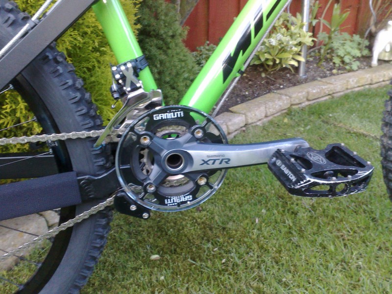

    Is this the front mech i need to fit a frame when i buy it.
    I am working out what other parts i want.
    Is it easy to fit a e13 drs to one?

    yeah that'll work and DRS or DS will fit fine with a bit of modification

    As derek mentions, that will work fine..... You may have to get the dremal out to fit the bashguard etc. Will not be too difficult though...

    Shimano make specific front mech's for duals, SLX and Saint.

    I did see the mechs for dual ring but decided as this is my only bike i will leave it flexible to allow for a 3rd ring.
    It will probably be ok running at 22/36 anyway but if it rides fast i will need that 3rd ring, and change it to a 22/32/42.
    Thanks again.Why cant all forum people be this friendly

    Norcosam , i have an SLX (22-36) crank fitted and run a XT front mech , i have just ordered a SLX double specific front mech to swap out the XT.
    Also i did a bit of reading before going the double ring and running a 22-36 , with your chain on 2-9 big front and small back (highest gear) its nearly the same ratio on a 3 ring set-up as running 3-8 , big ring front 44 and second from last small ring at the back . So the only gain by keeping the big ring is 1 higher gear at top end (usually on the road).
    If you have a 11-13-15-17-20-23-26-30-34 cassette ,
    The ratio on a double set-up
    36-11 = 85.1
    36-13 = 72.0
    36-15 = 62.4
    36-17 = 55.1
    36-20 = 46.8
    36-23 = 40.7
    36-26 = 36.0
    36-30 = 31.2
    36-34 =
    The ratio on a triple set-up
    44-11 = 104
    44-13 = 88
    44-15 = 76.3
    44-17 = 67.3
    44-20 = 57.2
    44-23 = 49.7
    44-26 = 44.0
    44-30 = 38.1
    44-34 =
    So you really only have 1 noticably bigger gear.
    You said you would run 22/32/42
    42 as a big ring
    42-11 = 99.3
    42-13 = 84.0
    My opinion is go for the double ring

    Ozzybmx,
    Thanks mate think i will buy the slx double then.Its also a bit lighter and a lot more compact.And most of all cheaper
    This one should do it i think
    http://www.chainreactioncycles.com/B...&StockID=97422

    If you change the standard bashring to one like the BBG above , you can shave 100g off the weight too, bringing it down to XT weight .

    i hae to agree with not going tripple ring, I can't give you any fancy numbers why except that when i came back from a weeks riding holiday (admittedly in the alps) there were 4 doop grooves in my bash so I was glad to have it.

    If you buy an E-thirteen guide dont run their bash guards, they weight a ton!
    Gamut bash guards are super light!
    Visit - www.gravity-sports.co.uk - Exclusive high end MTB Products
    2,018
    Thanks.
    Will look and see if i can get a gamut p30 bashguard in black.

    I think you need M667 and not M665 as shown? Can anybody confirm?
    2,018
    Just looked appears you could be right.
    This one
    http://www.chainreactioncycles.com/B...&StockID=97420
