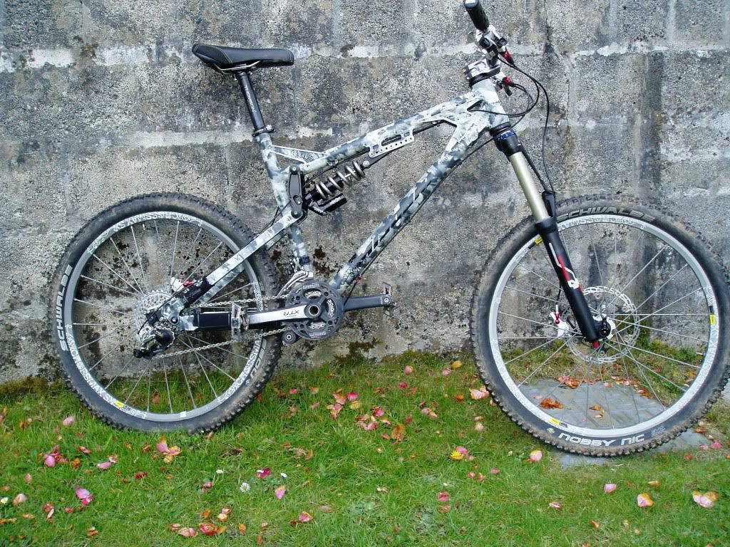

    Brought this as a play bike,Its still ok to do a 20 mile XC ride.
    Missed my FR,After i sold mine i realised that i had just sold a brilliant all rounder bike.
    Thanks to RPM for buying my ION and Whafe for selling me this and sorting out getting it 12000 miles to me.
    The 3 colour camo paint is stunning,
    Just stripped and re-lubed all pivots and bushings,All except the main pivot as i havent got an XTR M970 removal tool anymore(if anyone could lend me one i will pay postage),as i sold it with my cranks.
    Will be changing a few bits,the bars and probably the brakes.
    Few photos.

    think your wrists are gonna ache unless you move those levers!!!
    1,414
    Pretty sure I've got an m970 tool, pm me your address. The one with four prongs and threaded on the other side?
    Or we could meet up for a ride and then you post it back.

    Thats the one,4 small prongs on one side and a threaded part the other
    Thanks mate PM sent

    I went out yesterday for a quick blast.Feels good,might need a 600lbs spring for the rear.
    Brakes and bars now sorted,will have them this week hopefully.
    The low front and flat bars,makes it feel a bit different,but gives a lot of front traction,but feels a bit weird

    or just keep the bar stem combo and fit some float 180's
    2,018
    Quote Originally Posted by shakeyakey
    Some Bos Ndee 160mmmore like

    Its a shame they are a bit heavy for all day playing on.
    Will have another play with the Air pressure and damping,Cant quite get it to feel as i want,think the Devilles have spoilt me,wonder if the deville 160mm,or new 170mm would take a beating.Will be a sweet weight wit them on.

    New bars and Brakes.
    Went out today,prefer the wider bars with the low rise.
    They are the full 750mm.

    Quote Originally Posted by norcosam
    Was that tricky to do mate... what tools do you need?
    Wicked bike!

    2,018
    Quote Originally Posted by Karve
    Wicked bike!
    You need some good degreaser.I have Juice lubes brake cleaner in a spray can.Wear googles,it stings a little when it goes in your eyes
    Some good quality bearing grease or Marine grease.I use Huice Lubes bearing grease.
    4mm allen key and a 2 or 2.5mm for the Grub screws.
    A deep socket so you can tap out the bearing tubes.
    And about 2 hours if your bike is complete.

    Noticed my arms/shoulders ached a bit more than usual,Think it because i am further forward.
    It allows you to stay low and keep a lot of weight on the front,seemed to make it corner well,Bit weird when things get really steep,feels way to far forward,didnt go over the bars.

    Weighs in at a tiny bit under 36lbs,including tubes and 2.4 tyres.
    Waiting for valves for the tubeless conversion,will knock 1/2 lb off it.

    Thanks for the tips - couple of questions
    With the linkage did you just completely knock through from one side to the other the bearing tubes?
    What about the Horst link at the rear?
    www.essexhertsmtb.co.uk - Mountain Biking near London in the UK
    2,018
    On the Shock linkage plates,the upper pivot bearing tube is fixed in the frame so the Linkage plates just pull off,The lower pivot bearing tube is a tight fit into the plates,when you pull the plates off it will probably stay fixed to one of the plates,if not when you pull it out,theres a spacer tube between the arms with igus bushes each side.
    The Horst link and the Lower main pivot(stripped today,thanks The pilot) you need to remove the pivot tube,with either a Nicolai tool ot a long socket the correct size,Dont forget on the main pivot that there are 2 grubscrews that lock the pivot tube in place,they stop it rotating in the frame.
    I have a small hand press which makes pressing easy.But i stripped my old Fr with a socket and Hammer.
    The bearing on the drive side of this Fr is a bit rusty and there is a bit of surface rust on the Bearing tube,gave it a good clean with spray degreaser and have re-greased,will be ordering a re-build kit from Simon@Nicolai uk
