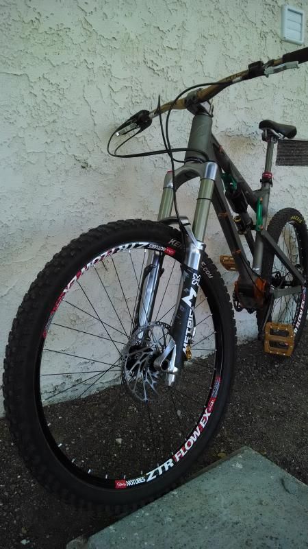

    Mind telling me which shock shuttle hole position you used tovfit your 27.5 wheels? Pictures would be awesome. Thanks!
    477
    not only does the 27.5 fit in the front. but the rear can be squeezed in too (2 hole from bottom on the shock plate)
