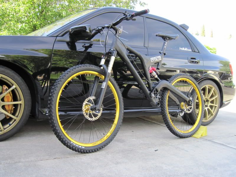

    i think my goal is pretty obvious lol.should look pretty sick mounted on the rack.
    currently i have cranks,cassette and front brake parts coming in.

    119
    Quote Originally Posted by Ericmopar
    Yep, it's looking good.
    What size frame is that?
    bike-26" 135mm rear.2.35 nevegals
    car-advan rs 18x8.5 +50

    Personally I'd stick with the Roco "for now" at least give it a try. If you decide you want a plusher ride then go with a coil.
    As for the longer shock, IMO: I think it messes with the geometry too much.
    Unless you run "a lot" of sag, The bike will sit higher in the rear and it will also steepen the head angle. Two things you "don't" want on a bike you plan to take downhill frequently.
    That said, a taller fork (160mm or more) might offset this enough to even things out, BUT It will make the bike taller overall,and do you really want to buy another fork already? LOL
