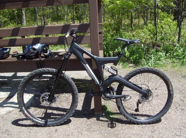

    heres the latest pics of mine. just put new wheels and rotors on

    Had mine for a few years, started life like this
    was like this for a long time
    And now looks like this
    Forks and seatpost I bought on Ebay both are as new for less than half RRP
    Stu
    Stu is offline
    77
    First pic should have been this
