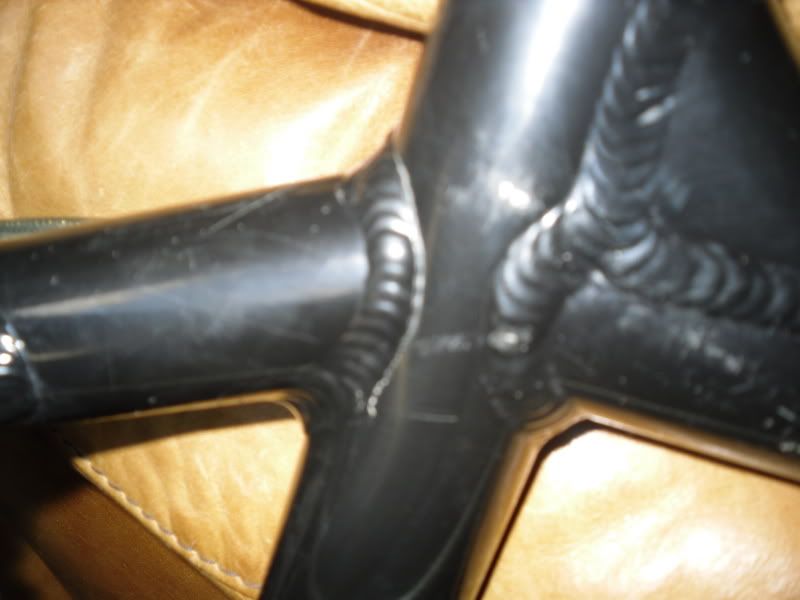

    On Sunday, 6/26/2011, I heard a loud "ping" while descending back to the trail head after a 15 mile ride. Thinking it was just a spoke breaking or maybe a rock coming up from my tire, I didn't worry too much and decided to wipe down the bike and inspect the next morning.
    On monday morning I cleaned the bike really well and couldn't find any amiss. So I loaded it on the car so I could meet some friends for a nice morning ride. That's where I noticed a nice shiny crack about 4cm long on the top, right seat post/rear triangle weld on the seat post side. Its a hairline crack that was hard to notice unless the light hit it right. Taking pictures of it proves difficult due to the shine of the frame finish and the small size of the
    crack.
    This first blurry picture shows the crack well because it picks up the shine the crack gives off to show exactly where it is.
    This second picture is a little better focus and if you look closely you can see it along the base of the weld.

    I can't see any reason that they wouldn't send you a replacement frame. Its not like these frames cost them a ton of money. The crack looks like a typical weld failure from normal fatigue. A happy customer is more valuable.

    You did not hear back from "Windsor" because they are not a real bike company. All the bikes on BD are owned by BD. BD buys the names of older, famous bike companies that went under, and then uses those names to rebrand catalog frames mostly built by Kinesis. There is no Windsor bike headquarters with employess waiting to take your e-mails and calls. My point is that it is best to just go straight to BD, since they are the only real company involved.
    As far as the damage, whenever you see a crack at a weld, it usually does indicate a manufactuers defect. The weld point should be stronger than other areas, unless the weld was performed poorly or the tubing is too thin for the force it receives. What it looks like from the pics is that the weld is actually separating from the seat tube, not that the seat tube is cracked. But again its hard to say from the pics. But I would guess its a bad weld. And for those that say "it has nice looking welds", you can't judge the strength of a weld by its appearance.

    A weld which breaks under normal use is a defective weld. This bike has seen normal use.
    I'll bet they replace it.
    I sent them a photo, then upon approval, the broken frame and they returned a new frame. I prefer to do my own wrenching and they were cool with that.

    Update: gotta keep this short, I'm on my iPhone. I received an email from Windsor and the apologized for the delay. They explained the warranty procedure and offered a no fault replacement for less than the shipping would cost to send my bike back in to them and them get the new one shipped back. Over all I'm happy right now and appreciate their offer. I emailed back that I would let them know what I want to do when I get back in town.
