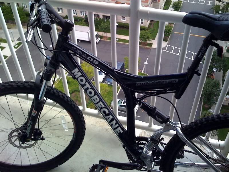

    i think i'm done with major things for now.
    might get new pedals, lights, etc...
    what do you guys think?
    104
    Is that Dart 3 in front ? Unless you got it real cheap................ Dart3 and Dart2 are almost the same and both are entry level cheap forks. There are nice forks for $200-$250
    Cloud 9 sure is a nice upgrade over the stock. I have mine at 150psi (I'm 180 lbs) and I adjust the compression depending on where i ride.

    Very nice!
    The Dart 3's are entry level,but pretty good forks considering.I'd ride them to death then replace them with something better.
    98
    Nice bro! You made the right choice getting the cloud nine. Have fun with her.

    Looks nice. I thought the Dart 3 came standard with the bar mounted poplock feature but I don't see it on your bike. Give a report on the ride and if you find any "bob" effect from the rear air shock.

    Hey guys, just wanted to make a couple of comments.
    Dart 3 i got dirt cheap (craigslist, taken off a brand new bike), and mainly for the reason that my dart 2 was leaking, and i didn't want to have to wait for the replacement without the ability to ride the bike. (Note: the size 1 1/8", 8' is correct)
    cloud nine, i also got for a good price, mainly 'cause i really didn't like the stock one.
    as for the reports of any "bob" effects - it'll have to wait a little for a number of reasons. first of - this is my first bike, and i'm not sure when/if i'm going to go for the trail or anything else other then riding it on the streets. also, i only got one chance to ride this setup, cause i'm on vacation right now, and don't have much time left for the bike.
    i think kolyan2k can do a better report, since he got the cloud nine a while ago... (btw, how do you like the easton pedals?)
