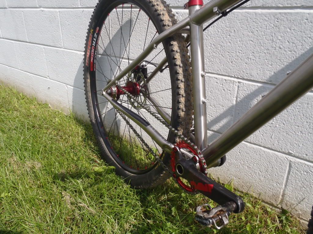

    Glad to hear you like yours as much as I love mine! I like the ride so much so that I have two, first was the Ti XX 2x10 and ive been racing that F*%&ER for 2 season now, LOVE IT! Changed the flat ritcheys bars for some with more sweep and width, swapped my Mavic Crossmax UST wheel set on as well.
    At the end of the season I wanted a matching SS, I searched and found a frame, bits and pieces here and there and WAMMO a matching SS Ti that Bikes Direct wouldn't build. The trick to my build was a White Ind. ENO rear hub, makes chain tension a snap, never slips and looks clean and hell.

    Quote Originally Posted by FirstStateCamber View Post
    Any more full on side pics of this bike? What size is it? Nice and clean look!
