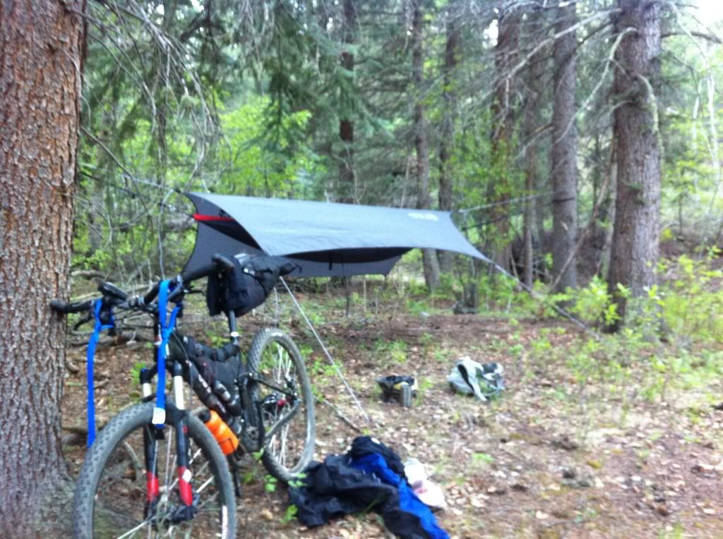

    Memorial day weekend I took it on the first trial run, fully loaded for a 2 day one night ride. I made it the 10 miles from my house to the Colorado Trail, and another 40 miles on the Colorado Trail to an area known as Buffalo Creek. I found a place to camp and then turned around and headed back the next day. 95 miles in total.
    <a href="http://s281.photobucket.com/albums/kk216/simon_suster/?action=view&amp;current=4874891d.jpg" target="_blank"><img src="http://i281.photobucket.com/albums/kk216/simon_suster/4874891d.jpg" border="0" alt="Uploaded from the Photobucket iPhone App"></a>

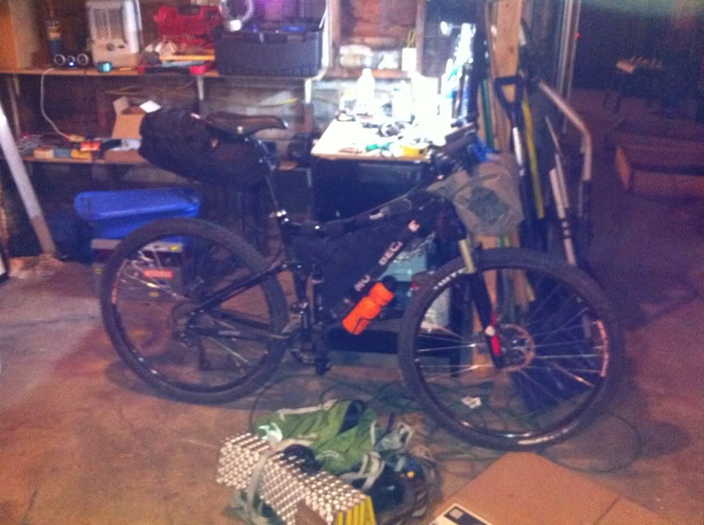

    On the bike are clothes and hammock (in the seat bag) sleeping gear (on the handlebars) and enough food (in the frame bag) for 2 days. Backpack has water filter, stove, tools, water, sleeping pad, and rainfly. The bike weighs about 49 lbs as pictured.
    Modifications to the bike.
    Since buying the bike, I have replaced the handle bars for some longer one, added some ergo grips and some Cane Creek bar ends for different hand positions. I changed the gear up by adding a 20 tooth ring to the front and replacing the 3 chain ring with a bash guard.

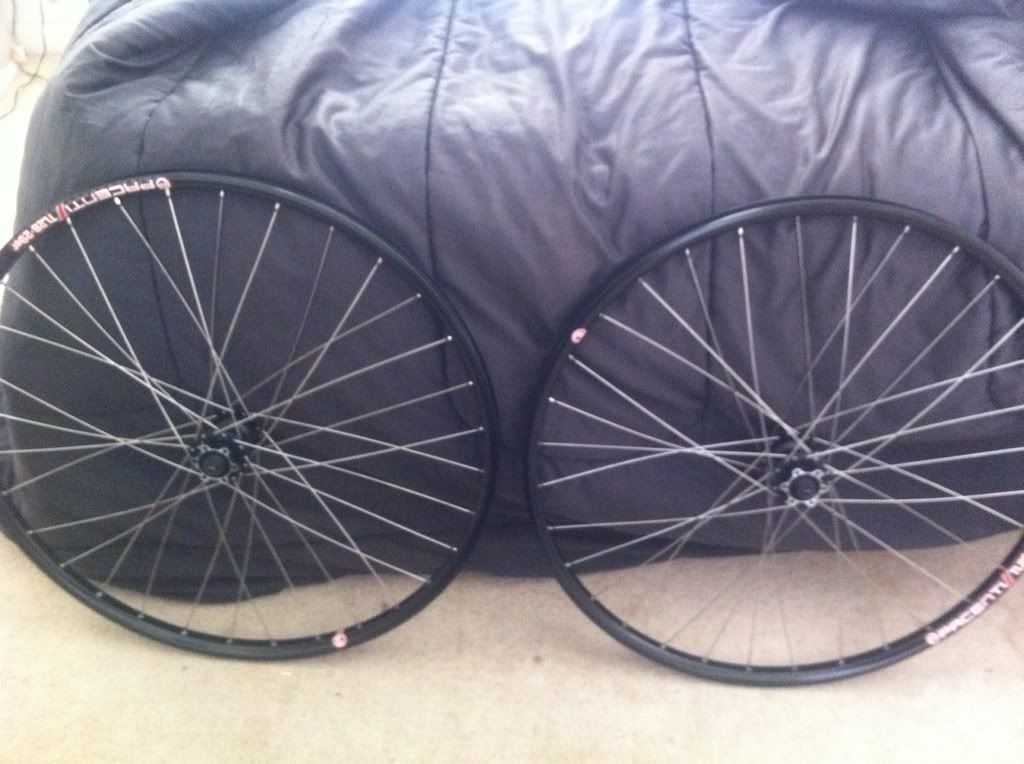

    I also built up a new wheel set for it. That was by far the single most weight saving mod. The stock WTB tires did inflate tubeless but they didnít inspire much confidence and I have recently mounted some Geax Saguaro tires and they are much better.
    The other addition is the frame bag which I sewed together and made from Cordura. I also have a smaller bag in the works that I will mount near the stem.

    Your pictures are blurry.

    What kinda bag is that under the saddle?

    Sorry about the picture quality, I just had my phone with me at the time.
    The Bag is a Viscacha made by these guys.
    https://www.revelatedesigns.com/inde...=4&ProductID=1

    Changing out the wheels makes this a new bike. I know from experience. I look forward to some more updates.

    What did you upgrade your wheels to?

    I used boughtPacenti tubeless hoops from here: BikeLugs.com, but I don't see anymore 29er rims on the site?
    DT swiss comp spokes with a Hadley rear hub and an XT front hub.
    So far they have been awesome on the bike.

    What hammock and rainfly is that? I'd love to try one out in place of my bulky a** tent.

    The hammock is and Eno, as is the rainfly. I think a hammock is the way to go for comfort, but I'm pretty sure I will be leaving the hammock at home for the race. It takes too long to set up, is a pain in the ass to get in and out of, especially with a sleeping bag involved, and takes too long to tear down. Plus is weighs almost 2 lbs.
    DarthTheo, no you don't need a sleeping bag in the summer, but I do use a Z-lite sleeping pad in the hammock since you're suspended above the ground all your body heat dissipates so having a little insulation between you and the hammock is nice.
    On the night that pic was taken it got down to about 31*F, with wind. I had my Z-lite, sleeping bag, bivy sack, and 2 layer of clothes on and stayed pretty warm.
