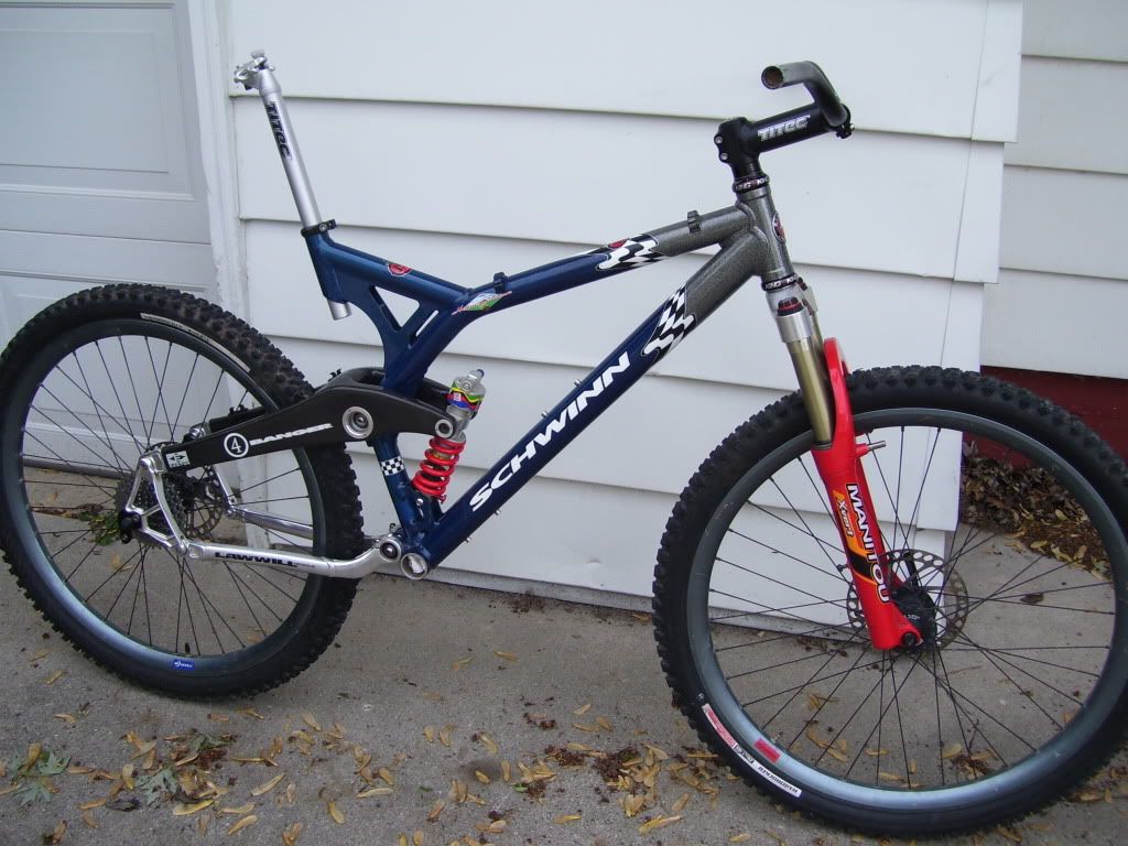

    Thought I'd post an update. It's looking like a bike now...
    Blingy Tomato, Titec and CK bits go good together.

    Damn you! I've been looking for one of those black tomato stem caps forever.
    Looking good so far!

    Seems like I saw one on ebay not that long ago. This one actually came with that junky 4 Banger that started this whole project.

    Love the fork. The X-Vert, I think, still performs well compared to today's forks.
    That seatpost, however, was the ban of my existence for a long time. The stupid knob would get gummed up extremely fast, and then you'd need to try and get in there, under the saddle, with needle nose pliers to turn it. *shudder*. Do yourself a favor and buy one of these, as it's cheap, works better, and is lighter:

    I got the seatpost from here:
    http://store.icyclesusa.com/titec-70...er-p22783.aspx
    I haven't used it enough to tell if I hate it or like it.

    Sette (Price Point's brand) also has several 26.8 posts for reasonable money, including carbon.
    7,789
    Don't worry, you'll grow to hate it as soon as you install a saddle.
    The Sette's a really nice 26.8 seatposts for a good price, but, unfortunately, they don't have any setback.
