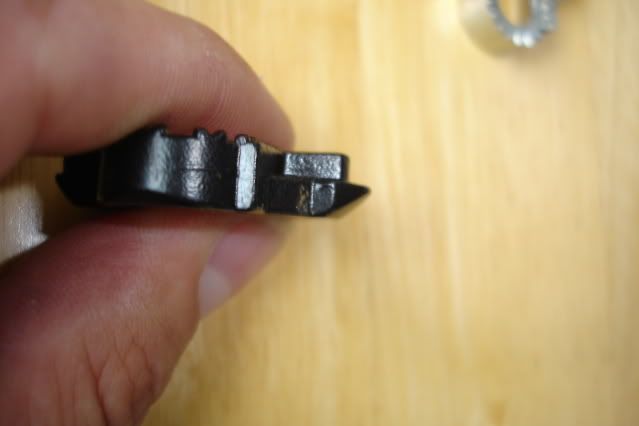

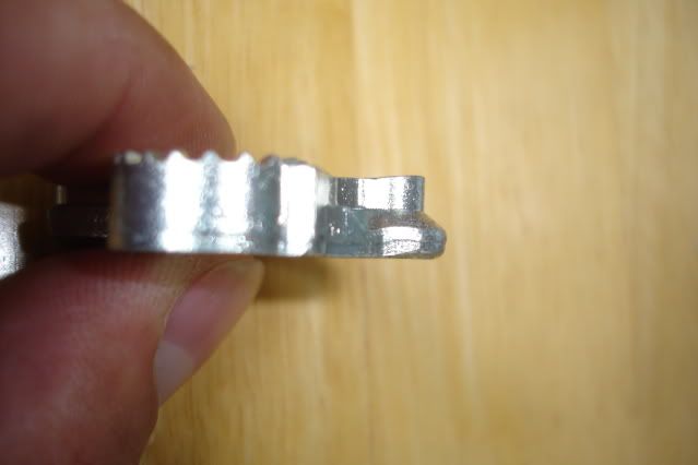

    * I did not know that Shimano makes two flavors of cleats; the SH51 "single direction" cleat, and the SH56 "multi-angle release" cleat. The pedals all ship with SH51's as standard, it seems. The 56 has a beveled front edge that enables you to roll your foot out of the clips, as opposed to only being able to rotate in the horizontal plane to get out. Since I couldn't find pictures of the difference online, here they are. Note that the top cleat is a Wellgo 97A, which is essentially the same as an SH51.

    * Without question, the multi-angle cleat is for me. I had two emergency offs on the test ride, one to each side. I got the multi cleat out easily; I did not get the single one out, and as a result was impaled in the leg over 1/4" deep with a thorn when I toppled. My natural instinct is to roll my foot out, and the 56's allow me to do that. The 51's say, "Sorry, you're going down with the ship" when I do that.

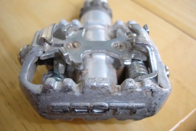

    * I then removed one of the Shimano pedals and put on one of my Scotts. The Scott is far more difficult for me to clip into than the Shimano, and it offers much less float (almost none). Release with the multi cleat was about the same, but clipping in was very annoying for me.

    So I just installed those Scott Clipless pedals on my HG, and have been on a couple rides. Having never done clipless before, I like them. But I noticed a funny noise that seems to be coming from the pedals when I'm pedaling. (Never heard it when I had platforms) Kinda sounds like a rubbing/creaking noise. I have the pedals set at the lowest clamping power.
    Is it from the cleats rubbing around in the pedal? Do I need to tighten them?
    How much should I tighten at a time?
    Crazy about Homegrowns
    Reputation: blue72beetle's Avatar
    168
    Well I tightened the pedals up. I finally found the little gauge on the pedal that shows where they're tightened to. Adjusting them in the dark isn't good.
    The noise has somewhat gone away, but it's still there a little. Definitely from the cleats interacting with the pedal. Kind of like a popping / creaking noise. Should you grease or WD40 these things or anything like that?
