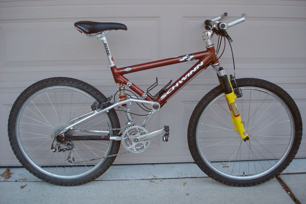

    Another one followed me home...
    I'm hoping this one puts me back in Bad Mech's good graces. I think it will, esp once I explain why I got it. I just added this beauty to the stable:
    98 Homegrown with XTR build other than the XT crank. It's VERY original, including the tomato chainstay protector and grips. The cool thing is, I had it shipped in from Colorado, so it came from its spiritual home. Now the part that I think will really make BM happy. The whole point of this is to turn it into one of those bikes with only one gear on it. I had two derailleur cable failures this year on my Intense, and grunting it out with only two gears (the crankset) showed me that this kind of thing would probably do my wimpy legs a world of good. Now, as a suspension snob, I could have just built up my old HG Sweetspot Carbon into a mono gear, but the aluminum ones are supposed to be lighter and I figured it was a great excuse to get serious about adding another HG to my collection that I wanted. This thing is in great shape - I'm going to kind of feel bad changing it up, but I'm going try and go light on it to give myself a fighting chance at enjoying the experience. I have ideas in my head, but I'm not sure the bike will lose much weight. We'll see. It's around 28 lb as you see it. I'm excited.
    I've named it Francis. I don't normally name my toys, but this name seemed appropriate. You might notice that I haven't called it by that thing most people call bikes with just one gear. There's a reason for that, which my bike friends know very well. So...in the Stripes tradition, the bike is Francis because if anyone calls it that other name, I'll kill ya.
    PS: The rear derailleur works backwards. Is this the "Rapid Rise" device I've heard so widely maligned? If so, I see why.

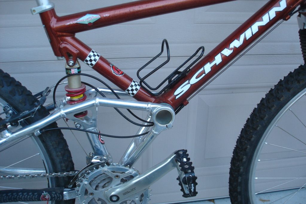

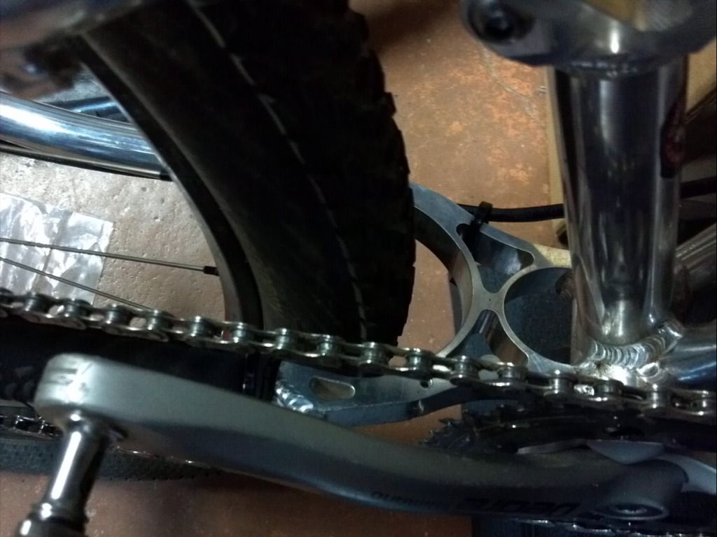

    Unfortunately, it doesn't look that way. There's ton of room down here on the Sweetspot:
    But only 1/2" here at this piece that routes the cables, which the HG hardtails don't have:
    Close enough that I'd want to test-fit before laying out the bucks.
    7,788
    Quote Originally Posted by CTB View Post
    Unfortunately, it doesn't look that way. There's ton of room down here on the Sweetspot...But only 1/2" here at this piece that routes the cables, which the HG hardtails don't have...
    Sounds like a perfect reason to pick up another Homegrown hardtail frame.
