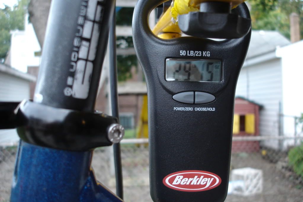

    Well, I met my goal of getting my 4B below 30 lb.
    Made me curious - has anyone ever scaled their Bangers? I haven't put any "exotic" parts on the bike, so there's still room to lose a little bit of weight, but I don't think much without sacrificing the usability and strength I have built in. The saddle is non-negotiable, but I could go with carbon bars, a carbon post (if anyone even makes a 26.8 in carbon), lighter Ergon grips (also not negotiable), a new BB/crankset (my Deore M510 and BB are 971g, so there's some room there), and so on. But that's all a lot of money. I could lose the bar ends, but I like having them. I've already converted the tires you see to tubeless with Stan's sealant, so other than an expensive, lighter wheelset, not much room there. (The Race King is 469g and the Mountain King is 580g, already pretty light for their size.)

    I don't know if you've done it yet or not, but I strongly recommend getting a kitchen scale with at least 1 gram resolution, then weighing every single part of your bike and putting it in a spreadsheet. It's a great tool to let you see where you're carrying weight, and to make the upgrades as effective as possible.

    I still have my 17" non-HG Banger that needs a couple welds touched up, so I'm good if I ever want to give up the HG. But as much as I'm an engineer, I also like the looks of my HG better, so I'm keeping it.
    I don't own a scale, but I have friends with one. I borrowed it while I had the bike torn down over the winter, and I already have the spreadsheet of which you speak.
    I'll post the build later.

    Turns out I was wrong, it's just a hair over 29 pounds. The frame is a beast, but the parts are light. Attention to detail is the key, all the small savings add up (skewers save 55g, rotors save 60g, etc.). One big thing is the 1X9 drivetrain, no front shifter/front derailleur/front cable & housing/2 less chainrings/shorter chain.
    Looking at the bike last night I determined there is about another 90grams to save, maybe more.
