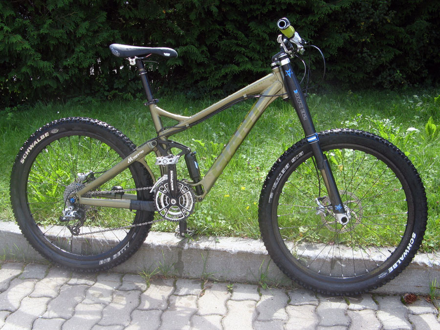

    ah, but there is a need - for me anyway ...
    i want to put more space (i.e. spacers, currently the nut is only long enough for about 3 or 4mm) between the upper race and the upper crown so i can raise my stem and handle bar - that is, i have about 12mm to go before the crown gets to the top of the Duc32 ...
    (yes, i've seen the other solution with the spacer, but i'm curious ... )
    the Duc32 is on a Giant Reign '05 (small), you can see what i mean on this pic:
    ragetty
    Reputation: Ethan F's Avatar
    351
    Crown explination
    The steerer shaft nut can only accommodate about 3-5mm of spacer including the top race and compression ring. (FYI, it is extremely important that the steerer nut fully captures the compression ring of the headset, this would be the full C.K. top cap for folks using King) In your case the only way to raise the bar is to use the spacers made by Passion Trail Cycles in Belmont Ca for the stem or a higher rise bar. The crown and steerer are to fit the head tube size , not to determine bar height. The reason there is not different length steerer NUTS, is that the leverage on the headset, head tube and especially the steerer shaft, would dramatically increase if you could just add spacers. You would be asking the system to take tremendous loads it is not designed for. At the moment the steerer shaft has no fore- aft load on it at all. This is because the crown is so close to the headset and all the load goes thru the crown to the top cap, bearings... If you leave the bearings where are and raise the crown, load will now be transmitted thru the steerer shaft. Since we do not use a standard steerer tube, which would have added at least 3/4lb and not be a Maverick, the steerer cannot handle this type of load. Hope this helps. I've seen some pretty crazy owner set-ups that scare the hell out me, folks NEED to look at the directions!
    Reputation: ragetty's Avatar
    582
    yeah, i thought it might be something to do with loads if the steerer shaft nut were longer.
    my "most sensible" option is to swap out the handle bar and stem for 25.4mm - the stem is raked higher and will probably get me most of what i need.
    although i do rather like the look of the OS bar ...
    thx anyway, ragetty
    351
    Looks like your at the 95mm position on the stem? The 25.4 90mm stem will get it up about 10-12mm more. And save about 80 grams too!
