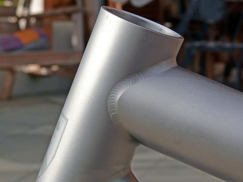

    that is very surprising to me.
    The welds on my brandnew OBED are very clean:
    How did you measure the alignment of the rear stays - do you have special equipment?
    39
    Thanks for the reply. My LBS is putting the bike together, not me. They are the ones who are measuring the alignment. As for the welds, I wish that mine looked like those...
