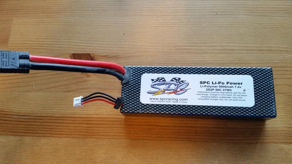

    Ok, so I've been a long time lurker. This is my first time posting.
    I've had my eye on the original Gimini Duo and Gloworm X2 for quite some time now, but have always been reluctant picking one up due to price.
    So last week I stumbled across some of these clones on DX and ended up purchasing a Securitylng version off amazon for $39. Shipping was super fast (3days).
    My main use will be for night skiing/snowboarding. I frequently ride in between lit runs in the trees where the snow is usually still untouched.
    Everything works as expected. Although after disassembly i was a bit concerned about a few things (don't worry i wasn't expecting this to be a top notch unit, and figured it might need some tweaking ;))
    First and foremost, I'm not to sure how long this unit will last given the poor heat management. The LED slug only really makes contact with the light body at the two screw down locations. It maybe makes a bit of contact on one side of the slug as you can see in the pictures. Ill be adding some thermal paste around the screw mounts to hopefully give it a tiny bit more heat transferability.
    Second, obviously this isn't water proof and I probably wouldn't even call it water resistant. There's no O-ring in the back end and the giant open hole in the bottom where the mount attaches doesn't really help either. Ill try and find an O-ring for the back half. As for the hole on the bottom I was thinking about switching to "vancbiker's" aluminum GoPro mount possibly with some cooling fins milled into the side. Then seal it up with some silicone.
    Not sure if i trust the battery or not. As you can see in the pics there is some sort of circuitry included, be it for charging or protection or both i don't know. It also looks like the individual cells may have protection as well (you can see what might look like a protection circuit on top of each cell). Either way i plan on using my 5Ah RC Lipo's with inline protection (still looking for a small circuit i can add inline).
    Also, i couldn't get the power connector to fully seat. I ended up using some sandpaper to sand down the ridge a little bit. Snaps in like a charm now.
    I'm quite happy with the selection of brightness modes though. Powered up, button lights up green and starts in the low brightness setting of the 3 main settings (low/med/hi). While in any one of those three brightness setting pressing and holding the button will enter into a more detailed menu with 10 brightness levels. If the light is off and you press and hold the button it will go into a steady flash mode.
    I'll test the run time once i get some thermal paste.
    Overall I'm quite happy for the price point. Even if it only lasts me a season or two.
    On to the pics! :cool:

    (4 cell pack. 2s/2p.)
    (My RC Lipo which i plan on using)
