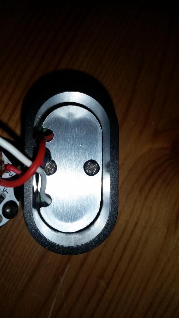

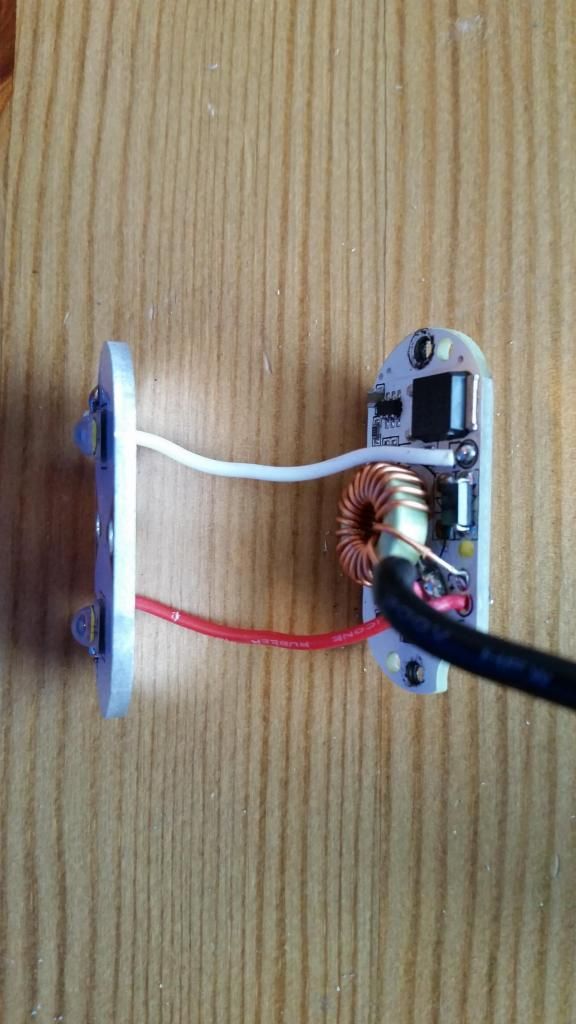

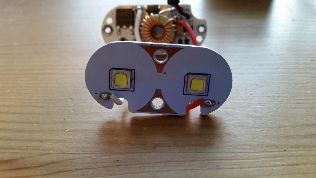

    Ok, so I just got two lights from Fasttech. One has a lens gasket and is soldered much better with standard machine screws holding it together. It also has a slight greenish hue when on (seems a touch brighter). The other has no lens gasket appears to be re-soldered (poorly), has standard philips head screws and projects a whiter light. So how badly did I get screwed over here? What would you do to fix it? Also wondering if its normal for a fully charged battery to set the button LED color to red directly after turning it on?
    User review: YINDING YD-2XU2 (Gemini Duo clone)-20140610_173053_1.jpg User review: YINDING YD-2XU2 (Gemini Duo clone)-20140610_173300_1.jpg
  69. #169
    Nov 2012
    800
    You need to add the gasket and change the wires optionally. These seem to be soldered ugly and may fail overtime. ... and check the driver side also At least they seem to have the same optic.
  70. #170
    Aug 2014
    Hi, I'm new here and instead of splicing power cable why not opne up light and solder new lead directly? Is cable too short? Anyway that's what I'd do.

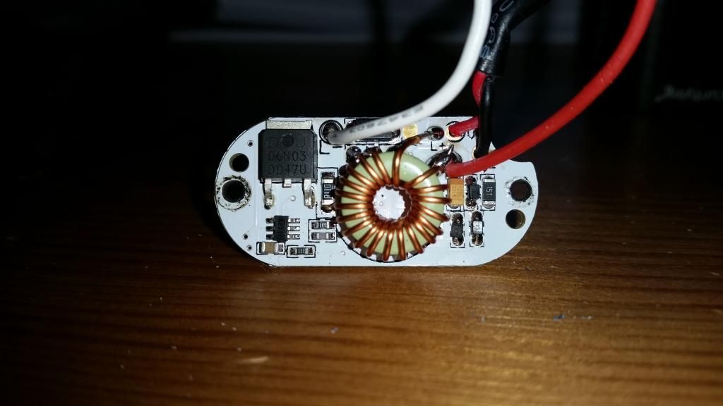

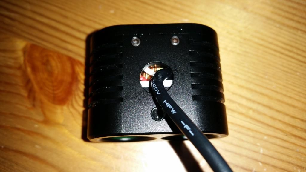

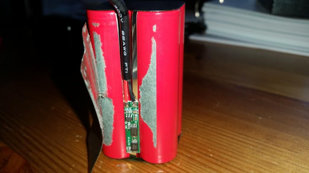

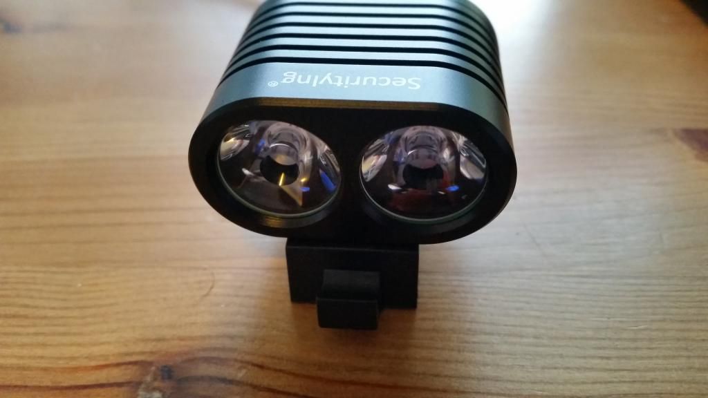

    Just want to share the results on my Chinese Roulette Game. Placed an order on: Waterproof 2300LM 2X CREE XM L U2 LED Bicycle Light Rotatable Bike Light & 8.4V 4400mAh Rechargeable Battery Pack & Charger-in Bicycle Light from Sports & Entertainment on Aliexpress.com Got a totally different thing.
    Did not get the Yinding (as described), but another one from SecurityIng. Did not test it yet on the trails but it does look good. Neutral White indeed; 10 stepless mode and CE certification. Was afraid I would have to pay more when shipping it to Portugal, but did not because it was sent from Netherlands apparently and because it had CE all over the package. I don't have much to say right now, so please take a look at the pictures.

    I'd unscrew the mount and see if it's sealed under there. It isn't the model shown on alibaba with the front screws and the cable exiting separately with what looks like a waterproof fitting. The lightmalls clone had a barely water resistant (if at all) fitting that held the mount and cable.

    I'm not home right now, but will definitely open it up (also because I'll be using vancbiker's GoPro adapter). I'm just waiting for some other parts and the SS X2 before buying it from him...

    Ok, so I've been a long time lurker. This is my first time posting.
    I've had my eye on the original Gimini Duo and Gloworm X2 for quite some time now, but have always been reluctant picking one up due to price.
    So last week I stumbled across some of these clones on DX and ended up purchasing a Securitylng version off amazon for $39. Shipping was super fast (3days).
    My main use will be for night skiing/snowboarding. I frequently ride in between lit runs in the trees where the snow is usually still untouched.
    Everything works as expected. Although after disassembly i was a bit concerned about a few things (don't worry i wasn't expecting this to be a top notch unit, and figured it might need some tweaking )
    First and foremost, I'm not to sure how long this unit will last given the poor heat management. The LED slug only really makes contact with the light body at the two screw down locations. It maybe makes a bit of contact on one side of the slug as you can see in the pictures. Ill be adding some thermal paste around the screw mounts to hopefully give it a tiny bit more heat transferability.
    Second, obviously this isn't water proof and I probably wouldn't even call it water resistant. There's no O-ring in the back end and the giant open hole in the bottom where the mount attaches doesn't really help either. Ill try and find an O-ring for the back half. As for the hole on the bottom I was thinking about switching to "vancbiker's" aluminum GoPro mount possibly with some cooling fins milled into the side. Then seal it up with some silicone.
    Not sure if i trust the battery or not. As you can see in the pics there is some sort of circuitry included, be it for charging or protection or both i don't know. It also looks like the individual cells may have protection as well (you can see what might look like a protection circuit on top of each cell). Either way i plan on using my 5Ah RC Lipo's with inline protection (still looking for a small circuit i can add inline).
    Also, i couldn't get the power connector to fully seat. I ended up using some sandpaper to sand down the ridge a little bit. Snaps in like a charm now.

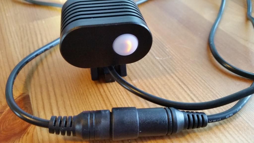

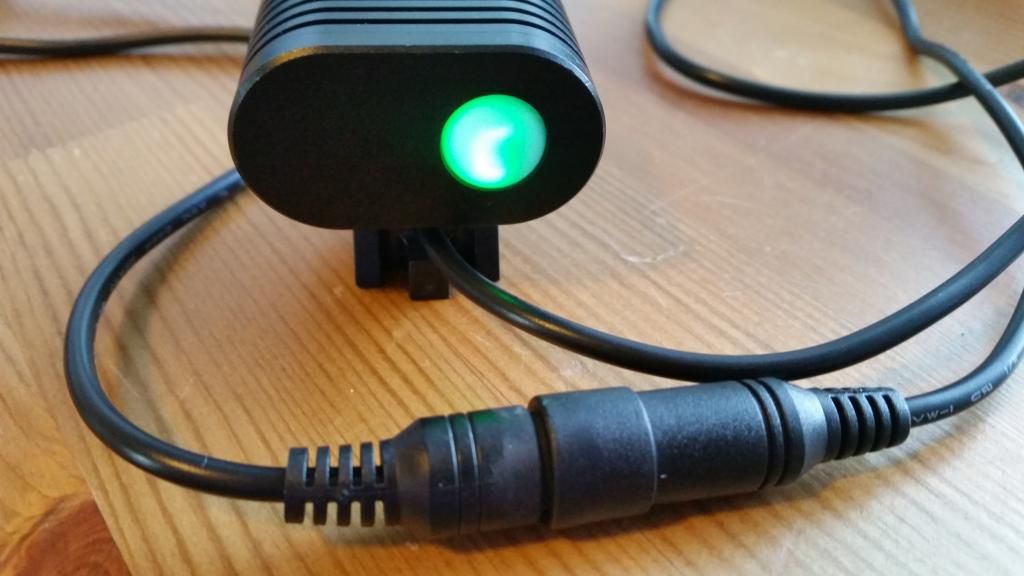

    I'm quite happy with the selection of brightness modes though. Powered up, button lights up green and starts in the low brightness setting of the 3 main settings (low/med/hi). While in any one of those three brightness setting pressing and holding the button will enter into a more detailed menu with 10 brightness levels. If the light is off and you press and hold the button it will go into a steady flash mode.
    I'll test the run time once i get some thermal paste.
    Overall I'm quite happy for the price point. Even if it only lasts me a season or two.
    On to the pics!
    (Quick shipping from amazon, packaged well)
    (Main brightness selection mode. low/med/hi)
    (Sub brightness menu with 10 level settings)
    (Giant hole in the bottom...)
    (Two small set screws that hold the back end by pressure only...)
    (Thin aluminum slug for heat dissipation)
    (Back of the aluminum slug. As you can see it really only makes contact on one side, and barely at that)
    (The two mounting surfaces for the slug, ill try and add some thermal paste here)
    (4 cell pack. 2s/2p.)
    (My RC Lipo which i plan on using)

    Whoa! I literally just minutes ago took many of the same photos of my Kaidomain Duo clone! Mine is the same except that I have a different driver without the programmable modes. How much current does yours pull from the battery pack on high? Is yours an 8.4v or 4.2v version. Mine is 4.2v (threw me for a loop as I bought it head only) and won't even run on 8.4v.
    For an idea on helping with the heatsinking, you could fill begind the emitter plate and up close to the driver with JB Weld (a permanent solution) or search BudgetLightForum.com for "Reversible Potting Option for drivers" or something like that. It uses silicon carbide mixed with "duct seal". That's my choice.
    -Garry

    Not sure about current draw yet. I'll be picking up a few supply's tomorrow (thermal paste and some new Anderson connectors). With the new connectors ill be able to connect to my existing lipo battery's as well as my inline Watt meter (reads voltage, amp draw, etc). I'm quite interested in finding out what the current draw is, i have a feeling that they are under powered. If they are using Cree XM-L die's they should be pulling close to 3amp's each...
    4.2v? That seams a bit odd. Each LED is rated for 3amp's @ 3.1V
    Can you post some of those pics you took?
  95. #195

    Actually, it is not that odd. It just means that his emitters are arranged in a parallel configuration. Your Securitying® lamp is likely using a board arranged in series. This is one of the reasons though that you have to read all the product descriptions when buying stuff from the Chinese web sites. If they don't list the battery or power requirements you have to send them an email to ask. While doing that you might ask them how the leds are configured as well. It can't hurt to ask, particularly if you are considering modding the lamp.
    Since you mentioned being interested in the current draw it would be more interesting to know what current is being supplied by the driver to the emitters. You could find that out if you unsoldered one of the power wires coming off the driver and placed a multimeter ( set for DCamps ) in series. Turn the lamp on high and you will have an answer. That said I don't know why it would be important unless you plan on trying to alter the driver. While I've heard of people altering the sense resistors I'm not sure that is a good thing to do.
    Anyway, I like the look of your Securitying® Duo clone lamp. I also like that it includes the variable output sub-mode for changing the mode outputs (if you choose to do that ).
    A couple questions for you: How long did it take for you to get your lamp and where was it shipped from? Since you seem to have a nice camera, is there anyway you can include some outdoor beam shots?
