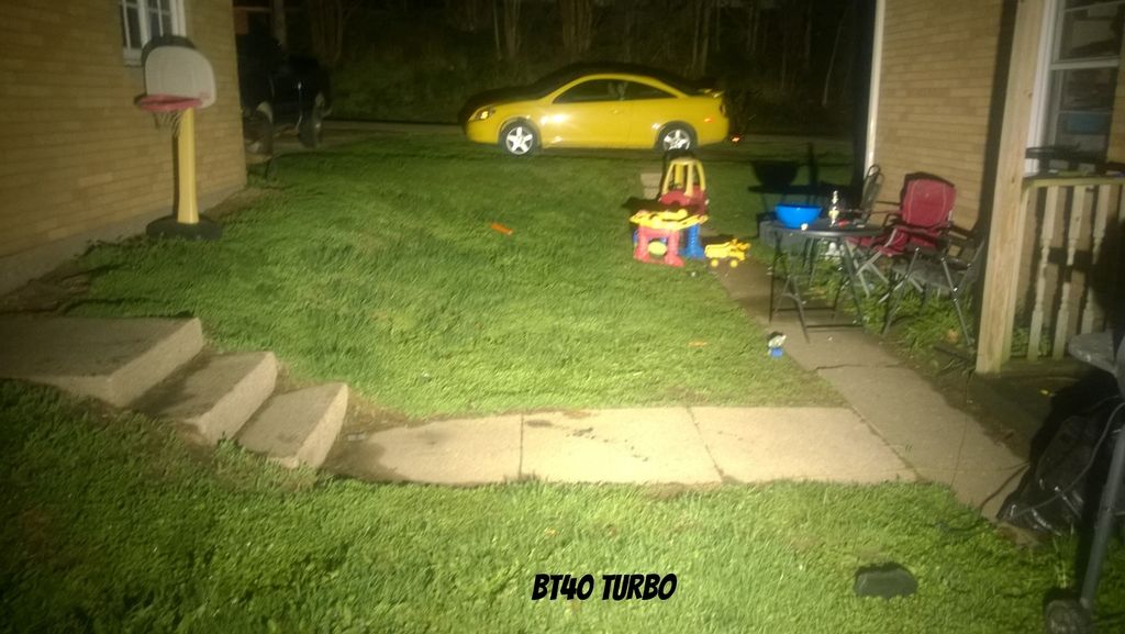

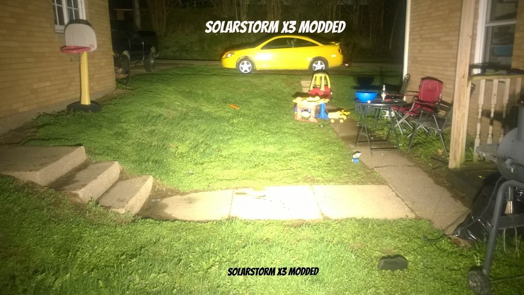

I could try posting comparisons to my SSX3 as I take my photos at the same locations. I already posted comparisons between the 872 clone and SSX3 elsewhere. I don't think I have Yinding photos yet since I already had snow on the ground when I received it (i.e. never got a chance to take pics in decent conditions).
By the way, remember this lights driver pushes the LEDs a tad harder than the EBay clone too.

Well I got sent back home from work tonight so wait for it to get dark to start working on all this. Yinding up first, then ill do comparisons on bt40 and ss x3, both are already mounted to my bike, black yinding will be added to bars and blue one (which I switched emitters around already) on my helmet. If it doesn't rain, ill head down to the park again where ive got space (and paved trails which are basically paved, wooded double track). And work on some pics.
Hope cat can get more done on his review tonight, he's way better at this than me so want his full honest thoughts on this thing.
Oh and @ cat. The oring has a seat around the perimeter that should be at the edge of the optic, but its slightly too big so urs very well may have popped out and fallen when you started to remove the optic. Mine is a little big. Nitefighter needs to know and correct that one, its a nightmare to get it to stay well enough to reassemble.
And ignore my question, I understand your thought process now.
