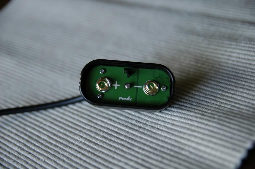

    Battery case holder is made from plastic has a screw down lid and holds two 18650 or four CR123A lithium batteries. The holder fits in a nylon pouch which you can attach via Velcro to the back of your helmet, bike frame or just put it in your water pack pocket. My dilemma is, it only holds two 18650’s. Why? There is no option to use four 18650 for longer run times. To me this is a deal breaker, as I would like to have longer run times with my lights without having to change them while on the trail. The holder itself appears to be of quality. Opening the case, you’ll see it has a washer around the top making this water resistant if not proof when screwed down tight. The case can only be closed one way and has markings on how the two pieces should come together. So there is no worries in reversing the terminals.

    Is there any protection circuit on the battery holder? Or do you have to use protected 18650?

    As to the PCB on the battery holder there is no info in the manual I assume there would be as it has memory and overheating protection. I was using protected 18650s. The green underside of the battery holders top is what I assume to be the PCB.

    I concur with Matthemuppet with the idea of looking behind the board on the battery holder. If indeed there is a PCB built in, then running protected 18650 just add more total resistant to the circuit and creating more sag. If there is no protection board, then a test with something like AW18650 or Redilast should be perform. Personally I feel Fenix should have provided the tester with whatever cell they used for testing to the reviewer in case of any doubts.

    As for the Fenix battery pack, I don't think it has a PCB on it. But I could be wrong.

    Reputation: colleen c's Avatar
    252
    Quote Originally Posted by Vancbiker View Post
    I have a hard time understanding how the battery voltage sensing would work right at all if you raise the input voltage to 12.6 using a 3S battery. The end of useful charge in that battery will be ~9V. That's higher than the starting voltage 8.4V of the original pack. I'm guessing the driver is programmed to change the indicator color or light output at set values. Maybe it senses the voltage when first turned on and that selects values based on the starting voltage. Anyone help me get this?
    Keep in thoughts that there are buck driver that can be used in a wide range of input voltage from the battery. They basically buck the voltage down from a higher voltage and provide whatever current such as constant current or PWM to the LED. The XML led needs an average of 3.2v to be driven properly. So the driver will buck the voltage down to the proper volt at the LED. I'm not really sure where exactly does these driver sense the change. For all I know, they might be sensing the voltage after the regulation and not right at the battery input source. So you can have 3s power sorce or a 2s power source and it should not affect the driver sensor for the low voltage cutoff or indicator although one would be a nominal 7.4v and the 3s is 11.1v.
    There might be an exception in this case for the Fenix light. The picture posted from pucked up show some circuitry in the battery pack holder. Not sure what it is. Low cutoff? Voltage regulator? Who knows.
    Picture posted from member pucked up:
    2,342
    that's not really how it works Colleen. Battery voltage is sensed as the difference between B+ and ground as LED voltage is determined by the current it's running at, which should stay constant as long as the battery voltage is above LED voltage + driver overhead.
    So if you program a low voltage warning for a 2S pack (6.4V or thereabouts), that will be way past the point where a 3S pack is overdischarged (8.25V absolute minimum). The easier explanation is just that there's something funky going on with the driver, which is borne out by Fenix's temporary removal of the light from the market. I would have thought they would pick up basic stuff like this before releasing a product though, it's not like they're amateurs.
    As for the board in the battery pack, it's not a PCB. For a start, there aren't enough parts and, second, 2S PCBs need a wire to go to the junction between the 2 cells (-ve pole of 1st cell and +ve pole of 2nd) to accurately sense the voltage of each cell. No idea what those 2 things do, but they don't have anything to do with preventing overdischarge that I can see.
    just a Newbie
    252
    Quote Originally Posted by mattthemuppet View Post
    Thanks for clarifying. I'm still in that learning curve So I guess that the Fenix driver must be programed to sense and know what the power source whither that 2s or 3s before knowing how to sense low voltage for the cutoff or mode change from Turbo to High. I do hope they get this problem fixed. I like the concept of multiple beam and hopefully others will persue the same course.
