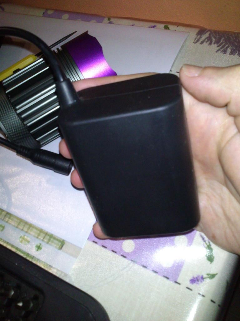

    The battery pack is a 6 cell thing quite heavy in rugged silicone cover and in a carry bag with straps - the whole package the light came in is about 1100grams! It came precharged to 7.7V I didn't test the pack just opened it and saw some 1800mAh cells in 2p3s (5400mAh) - near to advertised 6000mAh. If that is true - and it seems to be it is a nice pack seeing some 700mAh cells around :D We'll figure that out with my hobby charger. The manual states the light can operate 2.5hrs on high but I doubt. Then it should be some 10000mAh pack. I would expect about 1.25hrs runtime on high but that is a decent time with 32Watts on leds.The only issue is the heatshrink wrapping the cells is cracked on some spots. Connectors on head and pack seem to fil very well together. The pack has also a protection circuit so it should kick in if something goes wrong.
    Overall it is a decent light very similar to my 7-up. If someone is looking for an all-in-one package and as long as someone doesn't mind the weight of the whole set. 7-up is more a compact light than this D014 - 2 cm shorter and also little thinner at the back.

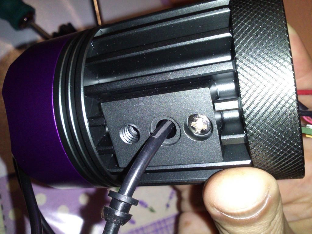

    Yes, it is a 1/4" thread, just need to unscrew the plastic mount:
    Meanwhile I've added a balance connector to the pack and it took a charge of 2700mAh to jump from 3.85V/cell to 4.2V/cell. I assume the capacity is somewhere between 5400-6000mAh:
