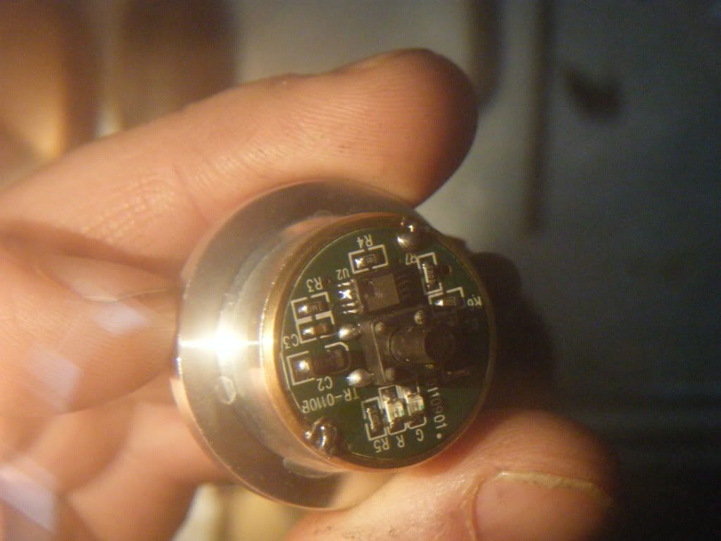

    There were no markings on the board that indicated that the emmitter was actually the newest T6 but based on the pattern of the emitter (7-bar grid pattern) and the production date of 20110901 I'm pretty certain it's a XML. I was happy to see a nice blob of thermal paste for heat transfer. On the board all the the solder joints were clean.
    The battery pack appears to be 4 x18650 linked in series and bundled in heat shrink. It's hard to tell if these are protected cells and I didn't want to take off the heat shrink. The cable and connectors pushed together snugly but they lack weather sealed caps which would have been nice. When I plugged in the light I was surprised to find the the batteries already charged. I put it on a volt meter and it measured 7.9V on the 3rd charge. Not the advertised 8.4V. Maybe it needs a break in time
