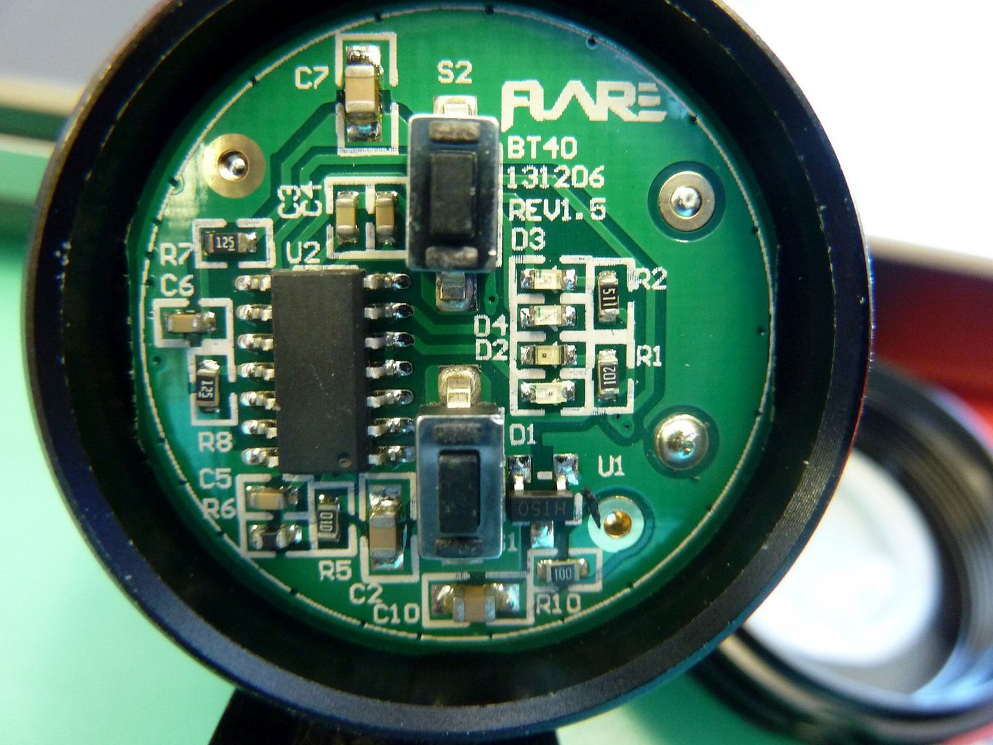

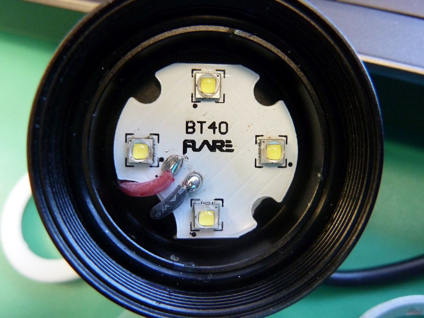

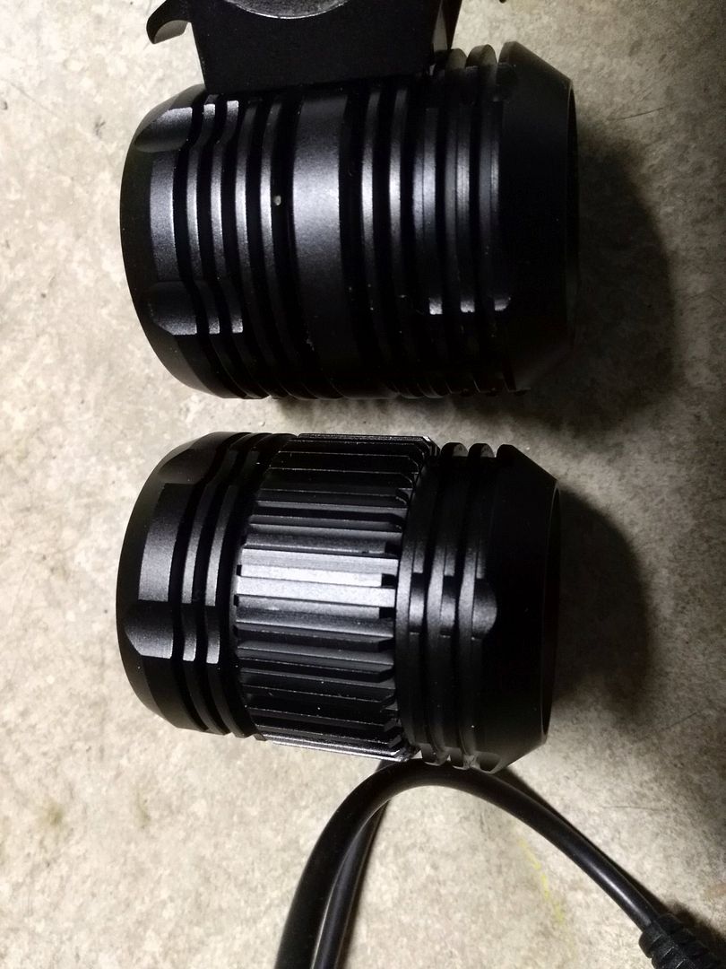

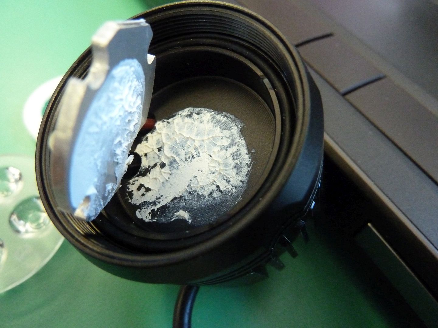

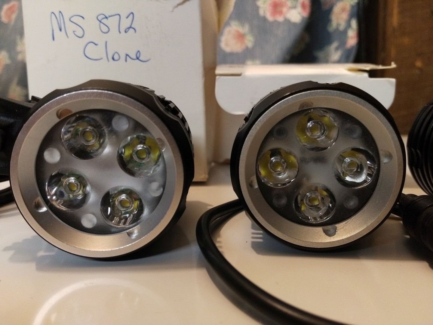

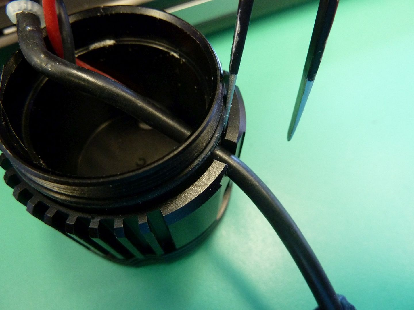

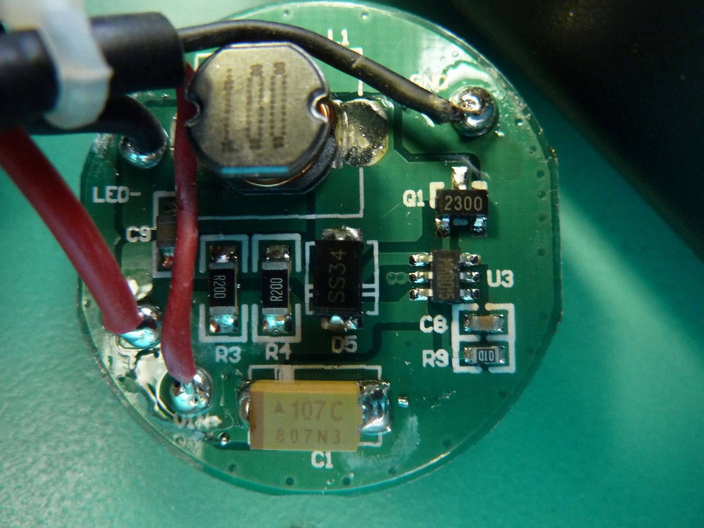

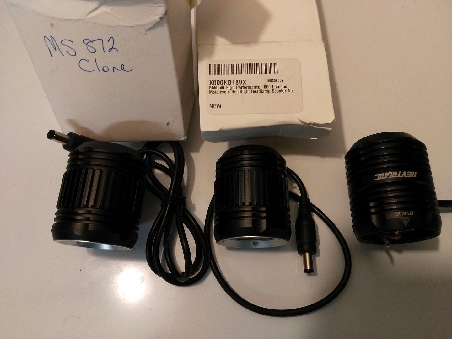

    I received one of these that I will call a "BT40S Clone" (I know, I know, they're all Magicshine MJ-872 clones). I ordered on Monday ("Fulfilled By Amazon"), it shipped directly from Shark Motorcycle Audio, and it arrived on Thursday.
    The quick & dirty - it's the insides of a Revtronic BT40S, put into a lower quality body that more resembles the older Ebay MJ-872 clone (varider linked above).
    The details - The driver and LED board look identical (completely down to the board markings) between this one and the BT40S. It has the "correct" U3 chip (MH8015), measures the expected 1.75A from the pack on Turbo, has genuine Cree XP-G2 (best I can tell) neutral white emitters. The inside has the solid wall where the emitter pcb mounts. The optic looks a little different from the BT40S, but I've not made any effort in comparing beam patterns (I don't have a stock BT40S anymore either). It looked as expected on a white wall in my basement. It's definitely a neutral white tint and looks like the tint of the original BT40S best I can recall - looks ever so slightly warmer than a 3C tint I compared to. It DOES come with the DC Plug and not the two separate leads shown in the Amazon link. It does come with the handlebar mount and 3 nice o-rings.
    Now for the only negative I could find - the finning on the outside of the body is a separate "collar" like sleeve that moves freely over a "tube" of aluminum once the end cap is unscrewed (i.e. driver access end). This of course means for bad thermal pathway to those fins and the outside air, though it remains unseen how much difference this makes in the actual use of the light. I would have had to unsolder the power lead in order to get the collar off and haven't done that at this time.

    Side-by-Side: Older Ebay 872 Clone, This one, & the BT40S:
    Same Order:
    Front View Old 872 Clone on Left, This one on the right (my BT40S is still disassembled):
    Side comparing This one (bottom) to BT40S (top):

    Driver front side:
    Driver back side:
    My opinion is that anyone interested in this light should jump on it while it is available for this price! I don't think you'll even get 4 XP-G2 emitters for less than the cost of this entire light! BT40S owners should pick one up in order to have replacement parts.
    -Garry

    Hi Garry, did you test the BT40s clone with a regular 8.4 V battery pack? Would there be any issues with using an 8.4 V battery pack on a 12 V light? thanks!
  34. #134
    Reputation: garrybunk's Avatar
    Feb 2014
    1,498
    Yes, I tested on my 6-cell 8.4v battery pack. I did NOT test it with 12v input (though Amazon reviews show others have). There should be no issue running this light with 8.4v input. My guess is that the driver will allow a wide range of input (must be at least higher than the vF of two of the LEDs in series, and I don't know the upper limit but it's likely at least 14.4v).

    First input point on the driver is C1 marked 107C. This is 100uF and max. 16V. So at this point 14.4V is possible. Don't know for the rest though.

    I bought a pair of those bt40 clones at the $6 price last week, I was just putting one on my bike one of the bases is snapped right out of the box. - good looking light, I think I'll be able to rig up a good mount.
    carry clippers! cut something off the trail every time you ride.

    My kid and I rode with the bt40s clones tonight (bt40s clone on one side, dual beam solarstorm on the other side, - 2 lights each), I took a base off an old magicshine and replaced the broken base that one of the bt40s clones came with.
    My take; decent light, not super impressive, noticeably yellow/amber. Good spread, but I think a pair of the dual "SolarStorm 8000LM CREE XM-L T6 LED Bicycle Torch Headlight +Battery US SHIPPING" for $14 shipped with battery and charger is tough to beat for the price. There were 4 or 5 of the solarstorms on tonights ride, the light is very noticeably whiter than the bt40s (everyone agreed), the solarstorm spread isn't quite as good, but two on the bars fixes that. I'm going back to the pair of solarstorms.
  74. #174
    5,479
    Quote Originally Posted by jimPacNW View Post
    The BT40's are using Neutral white LED's. I ran a quick search of the lamp that you mentioned and I had to laugh that it is advertised as "8000 lumen". Very odd that these lamps are using USB connectors for power connection between the lamp and the battery. That is very strange.
    I've used dual emitter SStorms before. Beam pattern is somewhat narrow because it uses reflectors. Likely they do out-throw the BT40's but the 40's are better for mountain biking. If I were riding on the road the SStorm would be my preference.
    I've also used dual BT40's before and found it more light than what I would consider useful ( when mountain biking on trails )
    Good luck with the cheap SStorms and watch those batteries carefully when ever you charge them. For the money you paid you aren't going to get great batteries.

    I have a Magic Shine 868 also which is much whiter light. In a previous post I saw someone suggest mixing a cool white on the bar and a neutral white on the helmet? I haven't experimented with it yet.
    To stay Neutral White on both bar and helmet, I am thinking of another one of these clones or a YinDing Neutral White.
    Any suggestions appreciated.
  94. #194
    RAKC Industries
    Jan 2017
    1,904
    Cool white on the helmet. A bt40s makes a horrible helmet light. Meant for light close to you, wont be able to see very fat ahead which can be bad at higher speeds.
