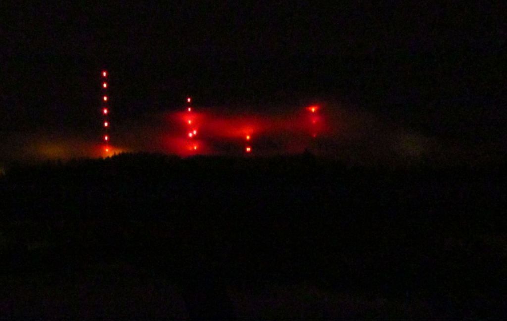

    Updated my first post with a video clip and a pic showing some side reflectivity/lighting options.
    Also from tonight's 29-mile ride:
    Welcome to Mordor, please enjoy your stay :thumbsup:
    Nope. Try as I might I can't figure out what I'm looking at. :confused: Just a bunch of red dots...(?!)..:shocked:
    The video was interesting though. Your triangle looks like it glows.

    mechBgon
    Nope. Try as I might I can't figure out what I'm looking at. Just a bunch of red dots...(?!)..
    Well, the main idea is it's got some active lighting that's visible from the side. You may have noticed that many headlights have the lens recessed into a bezel, and actually aren't visible from a side view... my other riding environment is main-drag city arterials where being merged into is a legitimate hazard, so side lighting is useful there.
