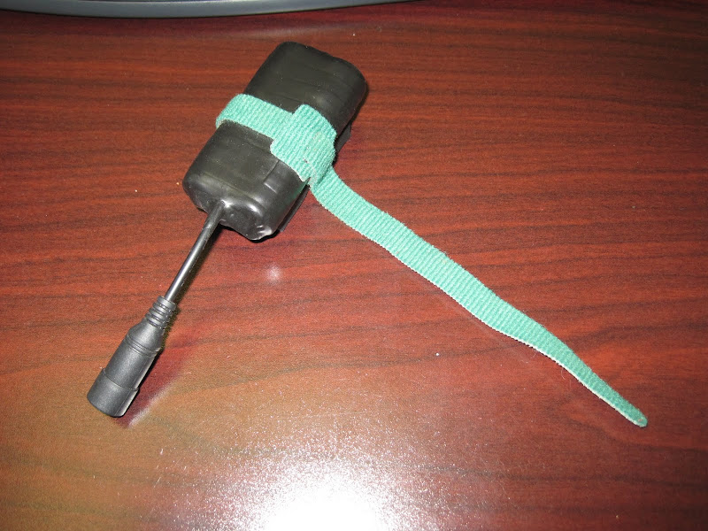

    I made my own battery

    ... for my MS light. Couple of 18650 cells off of dealextreme.com, I robed the trailtech connector off of my dead MS battery, and a velcro strap. I made a half sized lightweight battery that can strap directly to the back of the helmet, and connects right to the MS head. I still get 1:45 of runtime on high, but I usually run the lid on low or medium power. I think I spent a total of about $18 on building it.

    Oh, and I put two 3/8" thick, 1/2" wide weather stripping scraps on the back, so there is something to compress down when you snug the velcro strap. That way, it conforms to uneven surfaces, and doesn't rattle around or work loose.

    So glad that works. That was the solution I was hoping for. I still dislike how high the MS sits on top of the helmet, but that is a good solution for now. I may get the Mity Cross in the future and run the MS on the bars, but this will work great for now.
    Thanks.
