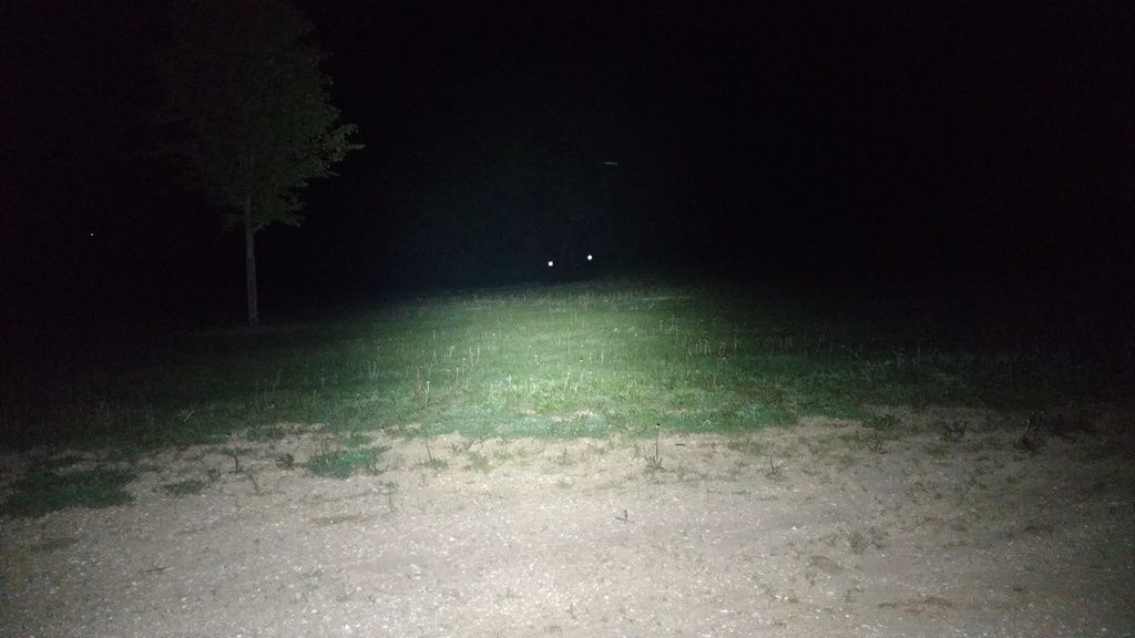

    Beam Shots (sorry the medium one looked like crap, i must have moved when trying to take the picture)
    Beam shot high:
    Beam Shot low:

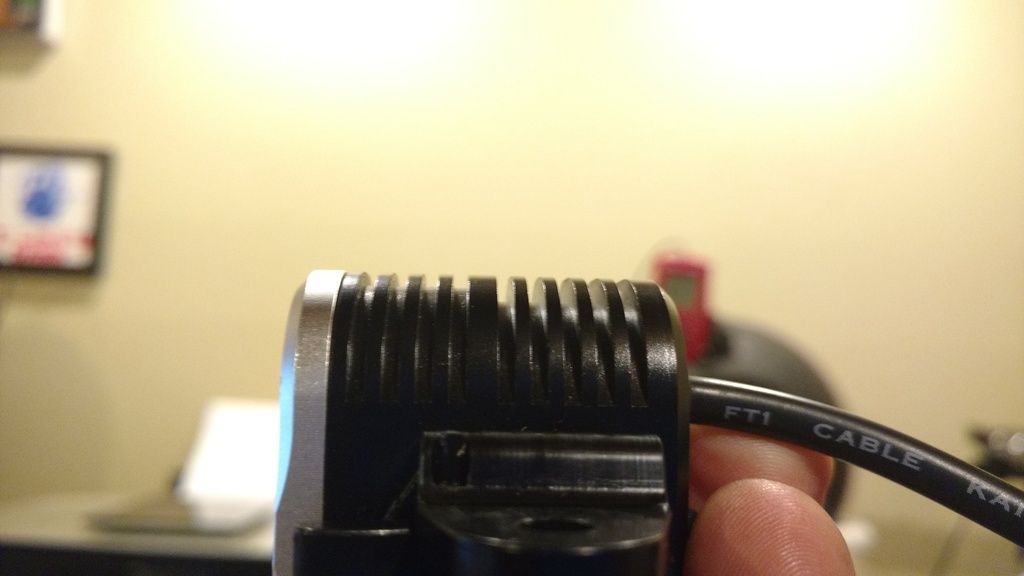

    It looks pretty good from what you have shown so far. Removable remote is a big plus for me. This has most of the options we asked for in the custom build: go pro mount compatible, programmable driver, wired remote etc. I don't understand why they have to use that stupid threaded connector on the wire.
    You have me a bit worried about the internal design with your last post. Is there a solid wall conducting heat to the outside or not?
    When you get a chance could please post picture of a top and side view of the light head. I want to get an idea of the depth of the fins.

    I should have been a bit more clear, my last post was referring to an electronic matter. Nothing to do with case machining.
    Yes it has a full, solid wall and such. It's correctly designed internally.
    I'll get this pics posted soon.

    Just for you Varider
    And beam shots added above.
    Nov 2012
    1,035
    Quote Originally Posted by tigris99 View Post
    That looks good to me. What do you think?
    Is that some sort of quick release slide on the buttom of the light (between the gopro adapter and the light)? That's a nice touch. Hopefully it's as sturdy as it looks.

    Can you show pictures of the remote plug? I am interested in knowing what type of connector it uses and where it plugs in. Is this a possible point where water can leak in? In the future I may want to know if I can make my own remote or at least an extension wire.
    Did you get a chance to take pictures of the internals while you took it apart? How thick is the wall behind the leds.

    Varider, I'll get pics when I can but modifications aren't really an option. The plug is custom molded around a male headphone plug. Button housing is also custom made and mods are going to damage the crap outta it. Expanded the diameter and oring to seal and lock the plug into the head. In line extension cutting existing wire and making it longer may be possible but I won't recommend it if your worried about water.
    Cant submerge it but I poured water over it and no issues for water getting in. I'm not sure how long you want that thing but it's insanely long in its own.
    And sorry not taking pictures of internals (I won't for new release brand name models to protect their designs) or disassembling to try and measure internal wall. It's plenty thick for heat transfer to the case based on what I see with the internal machining.

    Varider, Ill get a picture posted of the plug itself and the rear view of the light tomorrow (have them on my phone, best camera I got now by a mile lol)
    Wall thickness is calculated guess as there is 2 thicknesses. one where the mcpcb is mounted into the head then the surrounding material. 1.5mm thick behind the mcpcb directly, 2.8mm thick everywhere else. 1mm is all thats needed since it solid wall, so all good there. I knew it was PLENTY thick, but since I was changing optics, figured Id go ahead and check it with the caliper.

    xp2 light head
    Varider, here's a pic of the back of the light head with the remote plugged in
    Sent from my XT1565 using Tapatalk

    OK got a ride in at local trail.... VERY NICE!!! I used WIZ20 with flood optics on the bars (60deg optics by rating) which that is my "perfection" in a bar light beam. Then the XP2 with 1 stock and 1 25deg (wide spot) optic. Should have gone both wide spot optics. But even then was an awesome ride!

    I posted solo beam shots in the op's
    I did notice the video section I posted you can see the beam no problem at the very end.

    XP2 is here! My mail doesn't arrive till around 3 pm and the battery took almost 6 hrs. to charge fully so only got a short ride in. Noticeably more punch than my Wiz20 but stock 10 optics narrower beam than the "wide spot" I run in the Wiz20 is not to my liking. I ordered a set of "wide spots" with the light so I'll be changing those tomorrow. Riding in the morning and again tomorrow night so I'll get a chance to try out the "wide spots" on a longer ride (expect 50 mi.) and should have more info. Sunday.
    Remembered some people had issues with their Gloworm remote cables being to short so I took a pic. of remote cable length compared to my X2. Ituo button also has vastly better feel too.
    Mole
