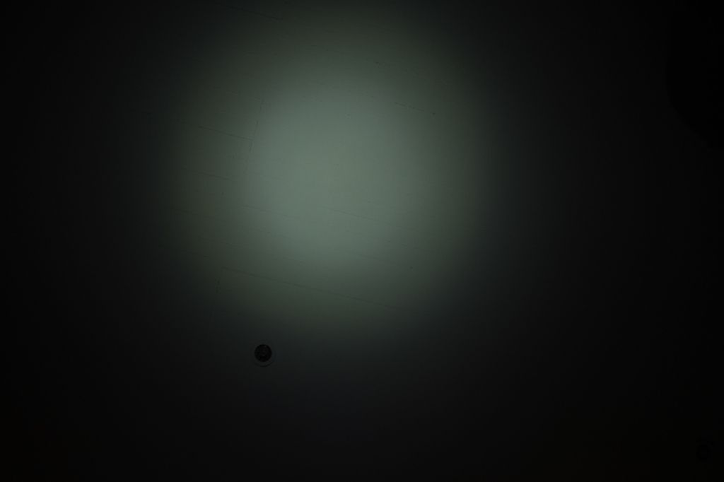

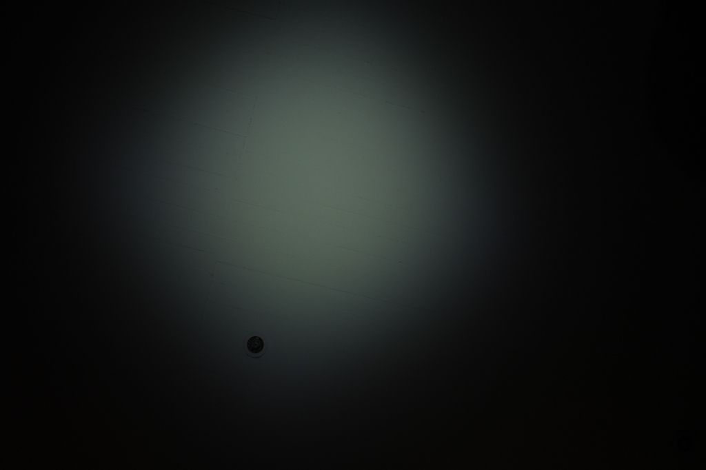

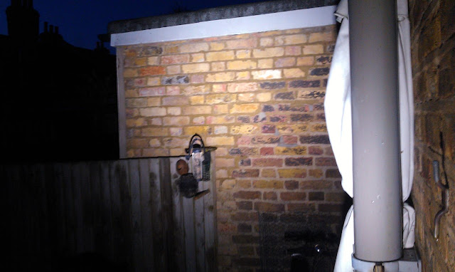

    I have experimented with various tints over the years with my DIY lights as I wanted things to look “real” just like they do on a nice sunny day.
    I have settled on the 2b tint for Cree LEDs as it the most realistic tint I have found so far.
    First I took a picture of a wall in my garden on a nice sunny day then locked the exposure and the white balance. I then took the same pictures at night with the same settings. First with a cool 1c tint LED light and then with a 2b tint LED light to find out which one looked the most like it did in the day. The 2b tint wins for me.
    I like riding on sunny days so I try to get the same thing at night
    Sunny day.....
    1c tint....
    2b tint...

    What an excellent example! The best in this thread so far. here. have some rep!

    Until the trails clear of snow and the temperature rises around here, I have just been doing daytime road rides and going on the bike path which is mostly clear. On the roads, especially when it's overcast, I have been using the Gloworm X2 in flash mode and I can definitely tell it gets drivers attention. I can see some of them stop to look at the bright flashing light coming up the road and 2 people said it was really bright. Right now I am just using it on the bars of my hardtail Rockhopper and so far so good. I look forward to using it on helmet in combo with my Lupine Betty on the bars when I start doing some trail night rides. And also look forward to digging out my full suspension Stumpjumper this year.
    Attached Thumbnails Attached Thumbnails Introducing Gloworm X2 - New Dual XM-L LED light system-1.jpg

    118
    Regarding the lens selection issue, i misplaced my narrow lens that comes with the "worm", so i placed a Ledil Tina XP xp-g lens i had lying aroung....
    I looks like a significantly more focused and a bit brightier beam in the middle. However, i cannot tell if it is as efficient as the OEM lens...
    Here's the oem narrow lens:
    And here's Tina:
    Height is about 3,5 metres
    And here's Tina:
    Looks a lot brighter in the beamshot. Have you tried it outside yet?
    Is it a double Tina or did you replace one or both optics. Also, was the first pic the spot-spot combo or standard spot-flood.
    I'd like to replce my spot-spot optic with something tighter if possible. A few millimetres bigger at this scale would make a noticeable difference. I presume the "Tina" doesn't use the little plastic holders that come with the optics.
    Finlly, where did u get the "Tina" from in the first place and how much was it?
