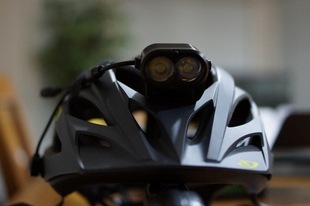

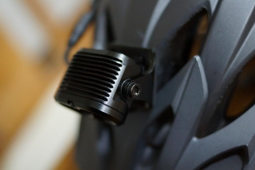

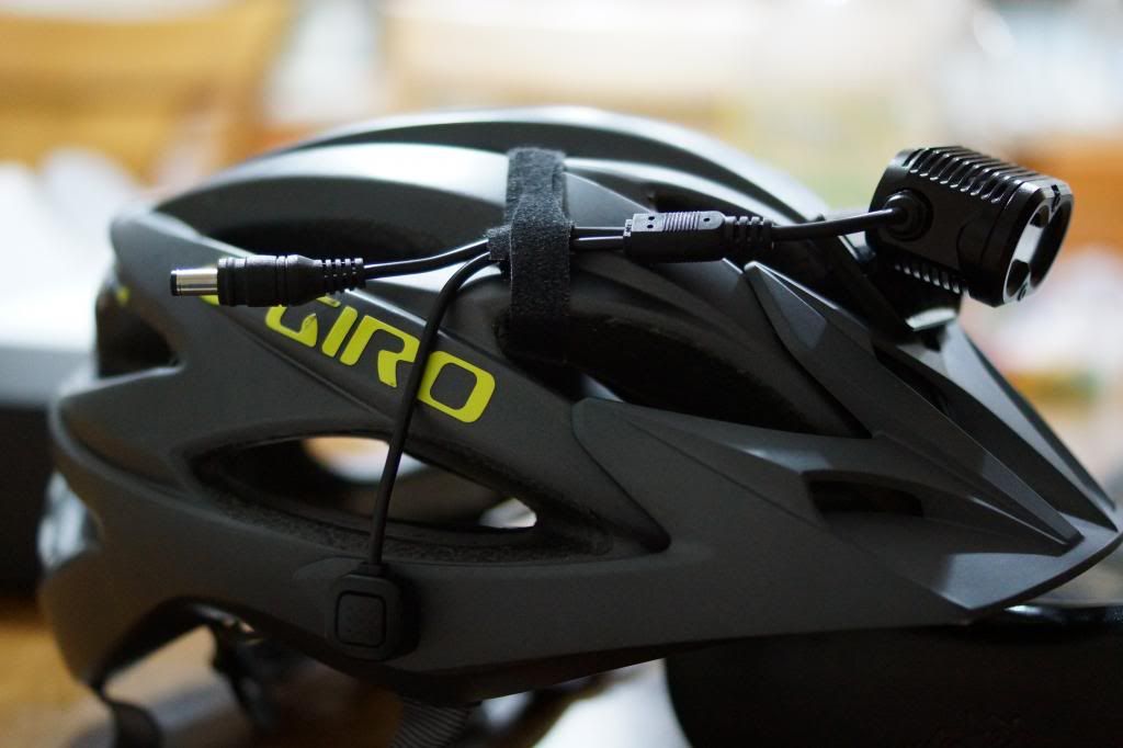

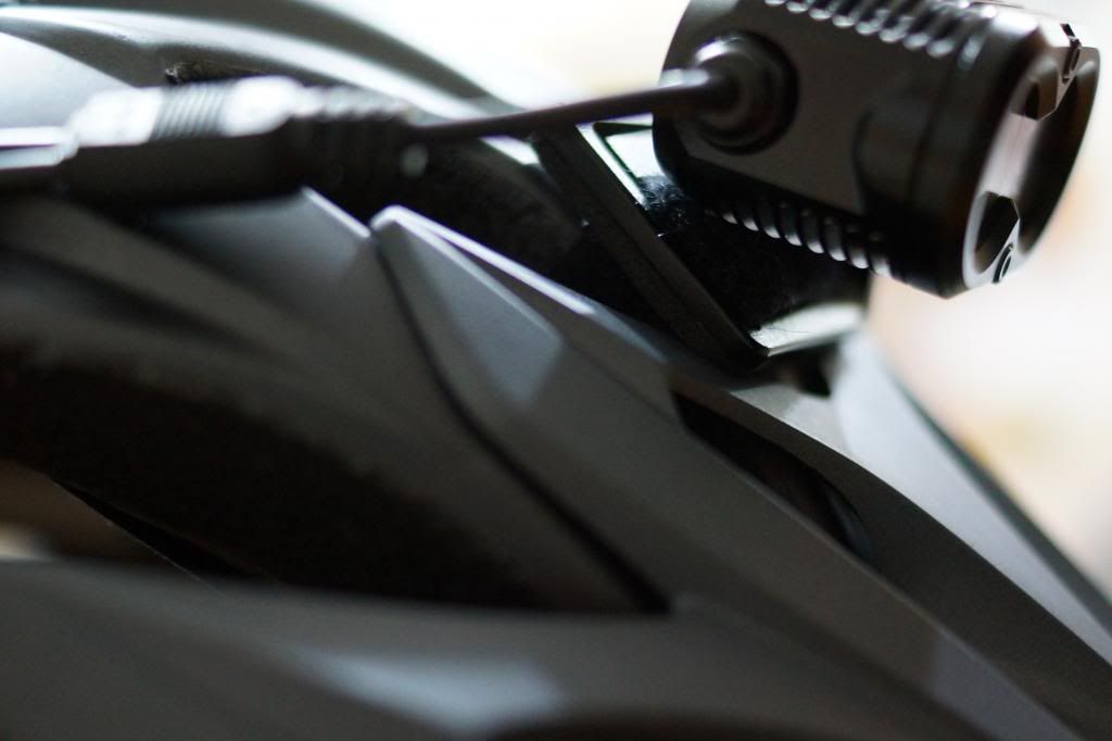

    thank you very much for the link. ill get it as soon as i find time to go to rei. meanwhile the one's from the tire pump will that you also suggested will do.
    i think ill have no problems with the light slipping as the mount is resting on the visor. if it indeed will slip it will only go as far as the visor goes.
    another close up shot of the mount resting on the visor
    a front shot
    side shot with the control
    im no light expert so im not going to go into detail as to how bright it is. this is my first light and what i want it to do is it better out-perform the old light(cygolight?) that my riding buddy lent me. i think it was just under 500lumens and it was a model from way back. how the light performs for me im yet to find out till i test it for a ride.
    id like to echo some feedback that was earlier mentioned though
    i dont quite get how GW got the right design(sticks after you wrap) for the velcro strap for the battery pack and not for the light mount.
    while the design of the velcro strap for the battery pack is usable, problem is its too short! im already having issues mounting the light on my helmet, as it seems the vents on my helmet are not GW friendly id have to also deal with the fact that mounting the battery pack on the helmet is not option.

    bapski--run the wires through the helmet channels on the inside and out the bach... This will be safer cause it will eliminate the chance a branch can catch the wire and either rip it off and or cause a crash--either eway==bad stuff...I have the battery wire go through my channels out the back--around a channel and back out..This will eliminate the cable pressure on the light head.. Then i lead the remote button out of the front side right vent and velcro the button onto the very right edge of my visor--this way its very easy for me to find--resulting in less time with my hands off the bars-safer
    thats what i thought of while taking side shots of the helmet. the wire could get snagged on a branch.

    i think ill have no problems with the light slipping as the mount is resting on the visor. if it indeed will slip it will only go as far as the visor goes. ...
    Looking at the pictures, why you didn't put the light a bit further towards the top of the helmet (ca. 7 - 10mm), so the bottom edge of the light mounting plate leans on the helmet visor edge?
  20. #995
    505
    Quote Originally Posted by PeterG View Post
    the vent i am mounting to is shaped in a way that its wider and curving outwards towards the top of the helmet and narrow and straight toward the brim of the helmet. so that if i mount it higher, it will slip because of the irregularly shaped vent ("v" shaped). had my velcro strap been longer i would have more options on how to secure the helmet mount. still waiting for GW to say if im getting the corrected straps that he mentioned earlier.
    on a side note, the picture above was taken while i was initially fiddling with how to attach the mount. i think, i may have it more secure now. i hope.
