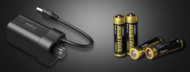

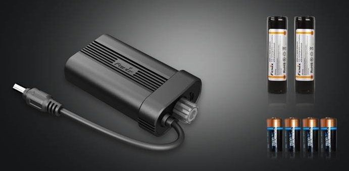

    The BT10 uses a 4xAA battery pack and the BT20 a 2x18650/4xCR123 pack. Either pack can be used with either light, but when using the BT10's pack with the BT20, the low battery light shows straight away.
    The BT10's battery pack
    The BT20's battery pack

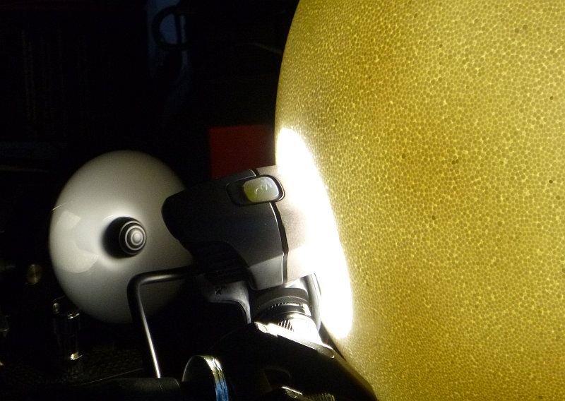

    To measure actual output, I built an integrating sphere. See here for more detail. The sensor registers visible light only (so Infra-Red and Ultra-Violet will not be measured).
    Please note, all quoted lumen figures are from a DIY integrating sphere, and according to ANSI standards. Although every effort is made to give as accurate a result as possible, they should be taken as an estimate only. The results can be used to compare outputs in this review and others I have published.
    The BT20 on test.

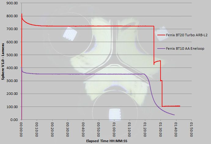

    The runtime graph shows the output traces for both the BT10 and BT20 running on maximum output and with a cooling fan.

    SW, glad you are doing another review on the BT20. Love your work as usual. I've been looking out for more information on the BT20 since it was mentioned to me that day. I particularly like how the BT20 lumen reading flatlines at the 10 minute point and maintains consistent brightness all the way to battery depletion. Can you explain at which point in time you determine the lumen rating of 763 on Turbo mode? 1 minute? What is the actual reading between 10 min and beyond? Also, are you able to say if brightness is improved if you used better cells?
    The lumen ratings I quote are according to ANSI specifications (or as close as I can get). This means the reading is taken 30s after turning on. I actually log the output from turn on and can then easily see what the output was at the exact 30s time stamp.
    Once the output goes completely flat, it has settled at 722lm (after around 16mins).
    The Fenix ARB-L2 cells used for this test have only a few cycles on them and are excellent performers. From past experience I would not expect any significant change in output level with different cells, instead only a change in runtime. Unfortunately I don't think I'll have time to re-run the tests with different cells to confirm if my suspicions are true.
