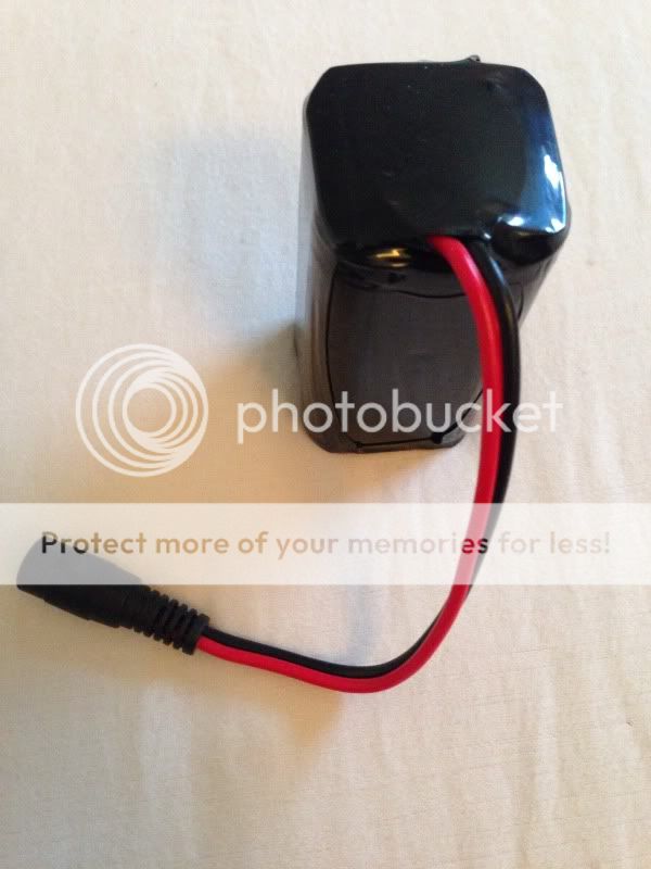

    This pack came with an SSx2. I'm having a hard time understanding what configuration this is? Seller description is 8.4V 6400mAh. On the sides of the batteries it states "IRC18650 3.7V", only other marking are the + and - symbols. I can find the IRC models in 1600, 2200 and 2400mAh. Samsung makes a pink IRC18650 model in 2600mAh. These must be the Purple People Melters.
    The Battery Thread: 2013-img_20141021_152647_872_zps74013e56.jpg
    The Battery Thread: 2013-img_20141021_152316_574_zps19e925b7.jpg
    The Battery Thread: 2013-img_20141021_152325_700_zps7467f39f.jpg
    Edit: I don't know what it looks like...

  26. #676
    May 2005
    3,084
    Someone effed up building that battery. It should be a 2S2P configuration. The mAh rating advertised as 6400 is using Chinese mAh which really equates to about 2000-4400mAh in reality.

    Aug 2013
    739
    Quote Originally Posted by Vancbiker View Post
    As in 'its not configured properly'? Because the configuration does not look like anything I've read about yet.
    Edit: I had the battery charging for four hours today, after testing today. The light on the supplied charger is green, so I guess that means the charger thinks it is full. I set the multimeter to DCV200 and the battery reads 8.4V on the MS power plug. My multimeter is nothing special($12 harbor freight), its amperes setting is 1.5V 4A, and gives a reading of 23.8.
    [SSx2]If I were to balance the Trustfires I linked and build a 2S/2P pack, what PCM would I want to buy; through huck_lee or or will this one work

    Aren't the left side batteries are the Pos terminals and the right side are the Neg.

    This is the middle wire of the 2S 3 wire setup on the photo. You can clearly see that one cell of three should be reversed. There should be two positive and 2 negative cell terminals if you want a proper 2S2P setup. The wiring here is wrong!

    739
    Quote Originally Posted by MK96 View Post
    The setup looks very wrong from everything I've read over the last week, what I want to establish is if this is even a type of battery configuration? We know it's not 2S2P, so what is it, just bad assembly?
    With a 2S2P configuration, I think I need a PCM that will handle 7.4V with 8A Maximal continuous Discharging current? Will this PCM work for x4 18650 protected 3.7V, 2300mAh Trustfires in 2S2P configuration, to run the SSx2?

    Nov 2012
    786
    It is a 2S1P and the rest 2 cells are useless in that config, IMHO

    739
    Okay, pulling it open again to see what PCM was used, since I didn't flip it and get a pic last time. Though, I'm going to drain it again before I do.
    Edit: 58f and raining out. Placed light behind house out of the rain with a sheetmetal bucket to capture the light, light is set on high. Put battery to MM before test, DCV reads 8.4v; (1.5v/4.0mA) setting reads 23.8... I need my friend to get back in town so I can use his analyzer... I got phone recording time to cut off. Will report how long it last.

    I see, it should be like this, yes?
  34. #684
    Nov 2012
    786
    Almost One red wire on this picture should get two plus cell faces and the other two minus faces. The biggest problem here is that three cells are plus oriented and one minus. Two/two would be OK. You need to split this pack or rearrange one cell - the topmost cell should be enough.

    Okay. Battery stripped 'again'...
    Flipped one battery for a proper 2S2P configuration. So then I decide that I need to test every cell. Okay, so two of the cells did not show a charge on DCV200, switch to DCV20 to look for really low voltage... None! Either the two batteries that were not wired correctly have deceased, or they have never been charged. At full the battery pack is 8.4V, 2380mAh. At cutoff the battery pack is 2.83V, 1170mAh.
    So I try to see if the i4 will tell me anything. I stick one battery in and in about 60s it tells me the battery is fully charged. When I remove the battery from the charger and test it, it shows (DCV200)1.6V. The charge wont climb any higher and the charger says it's done charging in less than one minute. Okay, so lets try the other battery in the i4 and see what I get. After 60 seconds of being in the charger, the charger is not reading that there is a battery in the charge port, the light does not even blink as it does when reading batteries, so I figure that the cell that was pointed out as needing flipped by you guys, is a dead cell, and all it has been doing is restricting current since it is the battery connected to the positive terminal with all the other batteries behind it.
    So I'm going to set aside the two working pink 18650's for now(which actually have a tight rating to each other; well matched) and wire my Trustfire 2300mAh(rated 2500mAh) batteries in 2S2P. Though, I need to find those "U" shaped ribbons, or any battery building ribbons(don't really know the name) like the ones a few pages back, because I've called all the battery and hobby stores in town and no-one sells the supplies for building batteries, except for shrink. Though there are plenty of shops that will build you one 30% more than online cost.
    Checking the number on the PCM, it is in fact a 8A protective circuit.
    I took all my trustfires and charged them one-by-one. Between all four Trustfires(using friends analyzer) there is no more than a .16V difference between the lowest charge and the highest charge at full battery, and there is no more than a 68mA difference in two of the cells. Seems safe?
    So my biggest issue right now is locating a place, either on the net, or within 25 miles of me, where I can buy ribbons for making battery packs. Links and answers are greatly appreciated!
    Vancbiker, if you have any of the ribbon in your stock, I would gladly trade you some beer and/or money for 5" in ribbon?
    I drive more when the streets need repairs! -'95 ZJ

  47. #697
    5,176
    Quote Originally Posted by pdxmark View Post
    After looking at this photo and knowing what lamp the battery was sold with, I feel at this point I would have to tear the shrink wrap off of every cheap Chinese battery I own just to make sure I don't have one of those. It is very obvious from the photo that only one cell is on the positive side when there should be two ( assuming two cells in parallel connected in series ( positive to negative ) to the other two parallel cells ). This scares the crap out of me. Someone must of left their glasses home that day before getting to the assembly line.
    @pdxmark, If I were you I would contact the vendor to get a new battery...AND, if you got this from an e-smay vendor I would lodge a complaint with e-smay.
    ( Edit; I just removed the shrink wrap off of one of my cheap batteries. No problems with mine. Actually the connections look much better than the one that pdxmark has. Anyway, still a good idea to check it if you own and actually use one of these. Personally, I only use the cheap batteries for testing and that very rarely.
