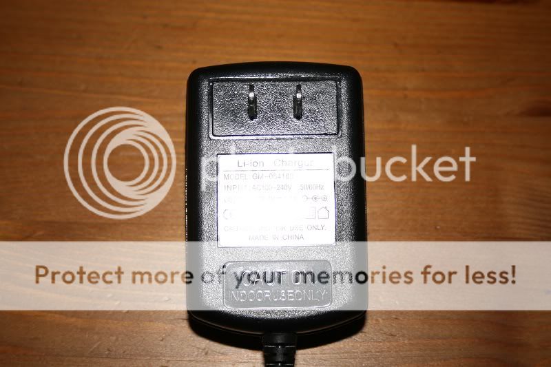

    And if you look beyond the actual warning, you'll discover that the charger that was shipped with your MagicShine lightset from GeomanGear probably is nothing like the one in that warning:

    Your pictures don't look like the pictures GeoManGear has on it's web site for the charger. Those pictures look an awful lot like the ones on the UL bogus listing warning page (which can be found here).
    I also don't see a UL file number on the picture of your charger. I'm pretty sure most UL listed stuff has a file number someplace on it, so you can look it up on their web site. I could be wrong, your charger may be legit. But if I were you, I'd do some research before plugging it again.
    So the batteries sometimes catch fire, and depending where (and perhaps when) you bought your MagicShine, it's charger might not meet standard safety practices. Oh yeah, those lights were a real bargain .
    I think I'll keep building my own,

    1,464
    How does this (from your link):
    Look anything like this (my picture from above)?
    I will admit that GeomanGear does show a pic of what appears to be that UL warning charger on his website in the listing for the charger on it's own, but the listings for the lightsets themselves show something similar to what I have above (and what came with the MJ-808 lightset that I bought from them in the fall of 2009).

    Quote Originally Posted by mhahn@hvc.rr.com
    ...I also don't see a UL file number on the picture of your charger. I'm pretty sure most UL listed stuff has a file number someplace on it, so you can look it up on their web site....
    My chargers are the same as BlownCivic's and my understanding is also that there should be a UL file number if the UL seal was legit.
    There was a thread WAY back that discussed it. I have always assumed that these are not legitimately UL approved and simply have not been caught yet.

    This light is sold by Deal Extreme, according to the UL notice, which provides a link to deal extreme.

    I have the same charger (geoman, not the deal extream one mentioned in UL listing), and came here to see about any updates too. As for now, I'm just being more careful with my charging, and will ride them if the weather ever cooperates, but looking forward to a more permenant and safe solution.

    Quote Originally Posted by BlownCivic
    Ok. I am confused now. My charger is the square one at the bottom. Does the recall cover both, or only the rectangular one in the top picture?

    Quote Originally Posted by skankingbiker
    Ok. I am confused now. My charger is the square one at the bottom. Does the recall cover both, or only the rectangular one in the top picture?...
    At this time there is no recall on any of the chargers. There is a warning from UL that there is one charger (the one with the model number UL lists in the warning) that is falsely claiming UL certification.
    There has also been some of us that speculate other chargers with the UL label that do not list the UL file number, may be falsely claiming UL certification.

    Hi all,
    My new MS light just arrived and sure enough it has the plastic/aluminum encased battery pack (as per http://www.dealextreme.com/details.dx/sku.44459). The battery showed 8v on the display straight out of the box - photo's here for anyone who's interested.
    I connected the MS head unit up and the light worked as expected - 3 modes (4 if you include off - high, low, flash); connecting the battery up does not turn the light on - the light starts up offline.
    Cheers - Steve
    Quote Originally Posted by Cat-man-do
    Just to keep the record straight: This new battery ( with the digital display ) was announced quite a while ago. However I wasn't aware it was released yet so maybe this is the one Geoman will have. No way to know for sure until GMan speaks up.
