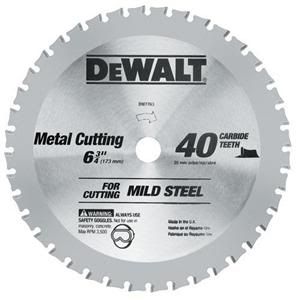

    Checked the local Do-it, Lowes, and Home depot today. Of course none of them carried an aluminum cutting blade. Lowes had a $70 steel cutting one -ouch! On my way out, I saw a display of dewalt circular saw blades. 40 teeth, welded carbide tips, and a pretty thin kerf. I figured what the heck! Just tried a trial run using lube and it looks good. Thanks for the input guys.
