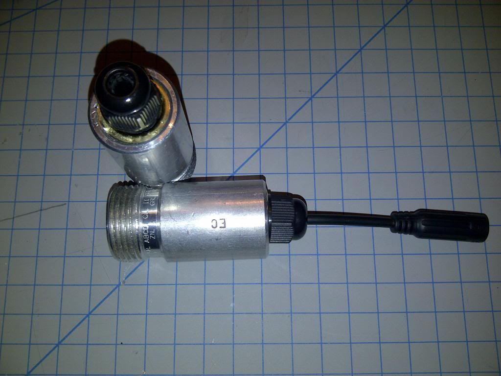

    Had some time over the weekend, I didn't do any biking so I build a couple more lights. This time I ended up using some parts I didn't use in the original build. I replace the Cup 2 slug at the bottom with the sliding closet door thingy that's on page one with a cable gland through it.
    Basically I drilled a 1/2" hole into the closet door thing so that the cable gland would fit through it. Sanded out some of the retaining nut from the gland so it would fit inside the depression of the closet thingy. Lock the gland into place and place it into the light body. You'll have to lighty hammer out some of the closet thingy sides to make it stay in place. Everything else is the same.
    These were parts I had that I couldn't use on my first build. I wanted to put the cable gland through the Cup 2 but was too thick. I would have to cut the Cup 2 but can't seem to find my hacksaw!
    The cable gland was bought from DX, 10 pack was about $5.
