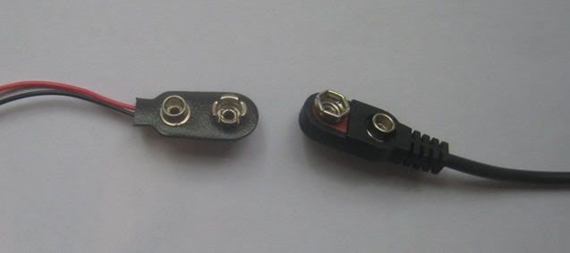

    Here's a photo of the PP3 connector from my lights next one from radio shack. The connector that's on my lights is nothing like the ones you get on kids toys, it's solid and connects very firmly. I've never had a problem and I definitely don't see them as a weak point. In fact if you look carefully, you can see how much metal is around the clip points compared to the cheap radio shack/toy level equivalent. I think these things clip on really well and the fact that they actually snap on rather than just push together like the lithium connectors is a plus in my mind. But hey, each to his own.
    I think what people are talking about is the battery holder and AA batteries not being held firmly enough in the holder (The holders are pretty typical with a metal spring at one end). Again I've never had a problem with this and all I do is MTB off road stuff. I've only ever used the holders that came with the lights. I would be a little dubious about using radioshack holders. Look at the difference between the connector types when going radioshack - I've never seen them, but maybe the battery holders are equally poor quality.
