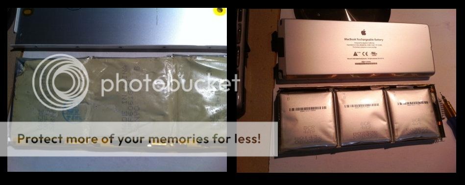

    I also came across the old laptop batteries, disassembled the Thinkpad T400 and Lenovo G530 batteries and I have got 6 x 2600 3.6V red Samsung cells and 6 x 3.7V green Sony cells. I recharged Sonys - heat up during charge (330-360mOhm int. resistance, charger stopped at 27 degrees Celsius) - so I am not plannig to use them. Now I am charging Samsungs (260mOhm int. resistance) to see if there is at least 1600-1800mAh, if not I won't use them too. I don't think used cells from laptop are any good.

    I think about 2-3 hour. I went for Lipo battery and this is my setup with the old protection from the pack and I added also a low voltage indicator with a buzzer Runs far far better now.
