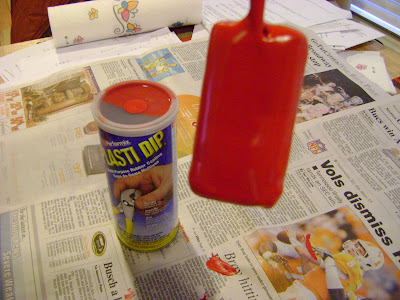

    don't forget DX - shipping may be a couple of weeks, but $20 for a pair of what everyone says are genuine Panasonic 3100's, with built in protection, isn't bad. If you have something like a Batteries+ in your area, they can weld tabs on for you. shrinkwrap or packing tape the batteries, then dip them in plasti-dip:
    panasonic 18650 - Free Shipping - DX
    http://3.bp.blogspot.com/_BDNOWIPmzv...0/DSC04491.JPG
