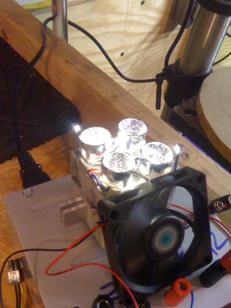

    my new quad mc-e
    just a teaser for now, but I hope to test it out this week. It's fully assembled and functioning, I can honestly say it's the brightest LED light I've ever seen.
    The entire housing was cut on my friends manual mill, it took a few months of cutting a little at a time.
    I'm using 3 warm white, and 1 neutral white (left over), with boomerang SS reflectors. It's being driven by a hipflex and a 18v makita li-ion drill battery.
    I'll upload more pics tomorrow.

    I still need to trim some depth from the rear housing cover. I'm pretty sure I can lose 10mm of depth there. We are also going to try to create a little more surface area in the fins. I'm very impressed with the output of this thing, it's a wide spot that gives a huge field of view but still has plenty of throw.

    Nice work, what is the heat transfer currently like? - just thinking if there would be a nice way to force air through the fins, I'm not sure how much airflow you'd currently get?
