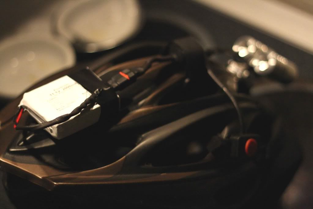

    (got my battery...still need to dip it)
