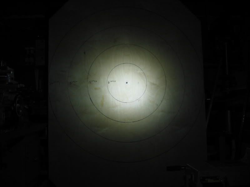

    just got some Ledil regina reflectors from Bram to have a play with
    quick target shot at 2 metres from the target ignore the colour as I have not got to adding an XPE R3 to the test bed yet so used the natural one already there .
    XPG
    XPE
    They do have a pretty tight bottom end so may go on one of Quazzles singles with a bit of dremeling

    Is it just me or does that XPG shot look just what we want for a helmet mount, tight bright centre with usable spill?
    Thanks for sharing Chris.
    Have / can you tried it on the MC-E?

    I have not yet shone it in the dark so no idea how far it goes the XPE looks tight
    not a chance on an mce the hole is XP sized

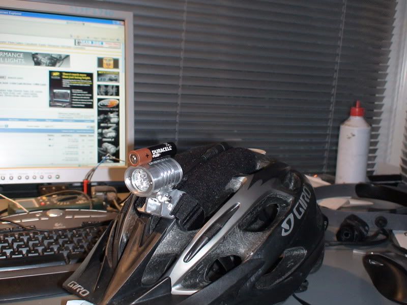

    then back on topic ref the Regina I have managed to cram 2 on to XPGs in the battery on board test rig so just waiting till dark for a walk in the woods .
    Reputation: bumphumper's Avatar
    Jan 2009
    136
    That test rig looks a bit too slick Mr Trout!
    This is my test rig.......
    3 x xpe r2 (carclo 20mm triple), 2x xpg r5 (regina)
    The xpe triple reduces the severe "cut off" that the reflectors create at the edge of the beam.... and help to make an excelent and very bright light with loads of throw and spill.
    Its a winner !!!
    Cheers Bram!!!
    3,062
    Damn and blast
    All systems go for a beam shot and the Daughter has gone and knicked my camera .
    I have just been shining it about outside it would appear to be a good un for a 2 led bike light . now where is that 1.5 amp driver 900 lumens from 2 leds Awesome
    3,062
    Phew that was close camera just returned
    You are not going to believe this is only 2 XPG`s @ 960 ma drive
    Yes the down side is the very sharp cutoff at the edges But you cant have everything

    I've got one from DX. It appears to be the exact same one. IMO it's a tad too tight for mountain biking. If I used a pr. of the drop-ins, I'd not only space them apart, I'd angle them out a couple degrees to be able to cover the trail in front of me....
    Yep, my thought exactly. Lately I've been using my XP-G drop-in with a drop-in XR-E reflector ( same size ). This reflector makes the beam a little wider, maybe because the opening is bigger at the emitter. (?) I think if you used both types you might get the best of both worlds, throw and spill. However I don't have two to test this theory out. Anyway looks like Brum is getting more of the Regina.

    troutie,
    The pictures with the Regina reflectors have a much less green tint than the others.
    Is that due to the reflectors or are the LEDs a different tint?
    5,696
    I was reading the data sheet for the Regina reflectors. What the heck is "metallized PC"? Is this some kind of plastic with metal coating?
    3,062
    Quote Originally Posted by yetibetty
    troutie,
    They are from the last lot I got from cutters which were XPGWHT-L1-0000-00H51 R5
    Being slightly colour defictive I saw now green tint

    so I ordered some of the Reginas from Bram. What would you use to cover the front of them to keep water out? Am I stuck going to DX?
    3,062
    Quote Originally Posted by unterhausen
    No your not stuck I bought some 1 mm and 2 mm thick Lexan from a seller on EvilBay and cut ny own
    or use a CD cover as a temp one if you go down the DX KD route only thing with the cd covers is they are a bit brittle so care is needed when cutting a bit of warmth from a hair dryer helps .
    another option if you have a welding supplies co the clear face plates for welding masks is good too , it is a throw away item so cheap

    Rhymes-with-vagina looks good to me! Future looks bright! I’ve been thinking lately that I need to try something with XP-Gs that really lets out the true potential of these amazing offerings from CREE. Obviously going with the seven-up XP-Gs and the larger 7-up lens gives more lighting potential than going with two triples (plus one single , in theory) each using the tiny 20mm triple lenses. Lameass idea of mine: larger unit (who cares about weight savings anymore???), using six single XP-Gs, each using their own dedicated 20mm optic—in theory it seems as though there would be more “usable” light, given the increased area of the optics. I’m not an engineer, by the way. Discuss.
    596
    My feelings are; reflectors have a better pattern than optics. This is subjective I realize. Also, it takes the optic manufactures a while to get ramped up for the new LED's. The good optics and reflectors are still in the works. I just can't wait to get my hot hands on Regina. I like her "V" cousin also. While I was riding last night, I was thinking about how nice 4 XPG's paired with Regina reflectors would be. Nice white light, only 4 LED's. This would about 18 watts input to the LED's. Couple of watts for the controller, about 20 watts draw from the battery. Three 18650 battery cells have about 27 watt/hours. Six cells will burn about 2 1/2 hours. This may be the bomb for a headlight. James

    what driver are you going to use with those? I have 3 of the Regina reflectors sitting in front of me, need order some emitters and then get down to the shop and turn out some light bodies.
    2,299
    Not so sure that the l31 will fit properly w/ the Regina...so I was considering an external buckpuck. $15...can't go wrong.
    504
    I've been using 2mm Lexan as well but have lost a couple of covers on my taillights.
    I tried lexan glue and silicon. The result was lost covers and time spent cleaning mud out of the lights.
    I now sand the outer edge of the lexan and stick it with polyurethane sealant.
    I haven't lost any covers since.

    Think I'll do a maxflex triple off my MS battery.
    2,299
    Got my 11.1v LiPo pack and charger OTW...
    External wired Buckpuck (already sealed and weatherproof it seems, but I heat shrunk it and silicone'd up the front. When I get the battery back and connectors installed, I'll seal up the back end too for good measure.
    2,299
    I dished out the azz'end to drop a bit of dead weight.
    Reputation: OverTheHill's Avatar
    Dec 2004
    425
    Quote Originally Posted by chelboed
    Why didn't you just shorten the whole light? Couldn't you have just turned down the last fin?
    2,299
    Because I didn't want to shorten it any more. The pivot is on that second to the last fin...if it pivoted on the very tail end of the light...IMO it would look silly.
  67. #67
    Dec 2004
    425
    I thought that was the case I just couldn't find that picture that you had posted on the other thread. Pity, but still a nice light.
    I might have a go at something similar myself if Cutter get the board sorted out for the Regina.
  68. #68
    2,299
    Were the pivot any closer to the front, it'd be drilled straight through the "firewall" killing the thermal path. I don't think it's a pity at all...it's a compact and proportional unit, but I guess I could make it shorter but I like it how it is.
    I plastidipped the buckpuck and connections last night....much smoother looking wiring now.

    Comparison with the ledil CXP.
    Maybe a wee bit tighter and better spill(not so obvious in the pic).
    Locating is a bit iffy.
    Troutie any tips?
