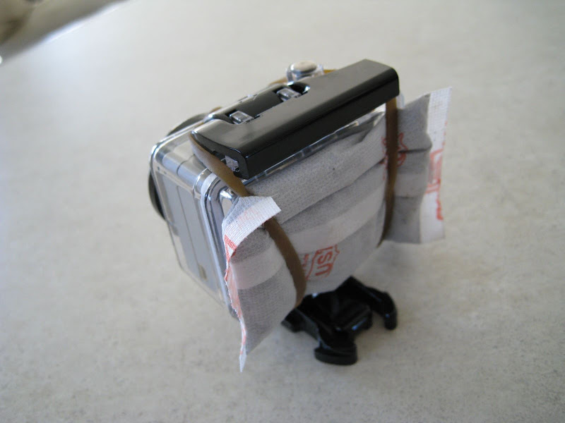

    I use 1000mah rechargables and get about 45 minutes (a lot less when it's really cold). I just carry an extra set. An external pack might rememdy the cold battery problem so I would not have to do this:
    <img src="http://lh6.ggpht.com/_vtmZU7exU8c/SWAY6CXdXzI/AAAAAAAAA7g/UC_e9nv2l-s/s800/010.JPG" />
    I'd mainly be worried about compromizing the waterproof case.

    Yeah, I remember seeing your post showing that - really clever!
    I would think that for MTB'ing the small decrease in splash resistance (since it's nowhere near waterproof anymore) would be minor. Could possibly even hot glue the hole.
    I read somewhere that you can power it through the USB -- I'll have to try that as well.
