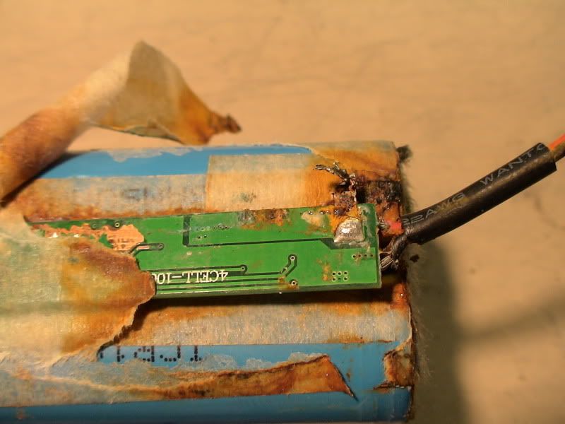

    Just a warning to folks dont let water in your battery packs it doesnt take long for a new pack to suddenly look like this and stop working .

    I had better get on finding a way to water proof my 8 cell pack. I dont really want to buy plasti dip since I am so cheap. The 4cell packs slide into mtb tubes nicely, I just zip tie up both ends and double bad them seems very robust. The smaller tube sizes work well for 2cell packs also. Maybe I can get hold of a pugsley sized tube or a moto tube.

    Oxygen, water, and electricity (a little electrolyte helps). A powerful combination. Essentially, a slow burn.
    A partial seal keeps water in much better than it keeps it out if there isn't enough heat to vaporize the water out of the pack before the next influx, which would be par for the couse in Yorkshire.
    Seeing is believing. Thanks for sharing! Another good deed done dirt cheap (after destruction, anyway).

    I have a couple of packets of those moisture absorbing crystals in my battery bottle, not that any water gets in but I did notice a bit of condensation forms when I seal the bottle in a nice warm house and then take it out into the cold.

    Was expecting worse when I opened the thread.
    Unfortunately even if you did form a perfect seal around the battery the container would still fill up with water. I never believed it until I saw it happen on a few subs. Best thing to dod is if the batteries are cold let them remain cold in the garage. This way you won't be forming condensation on them each ride and they last longer.
