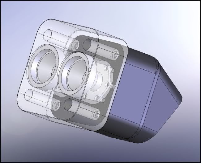

    I designed a block that would hold two leds and attach to a niterider housing. The idea was to make something that just bolted on. You wire it to the existing wires.
    In my case, it was a 6 volt nightrider cyclops so I could use some of the simple regulator circuits that output 750 mA with an imput voltage between 5 and 7 volts. Your case, you will have to deal with regulating 13.2 volts or put 3 leds in Series with a 3.5v regulating circuit. You could make a larger mount if you chose 3 LEDs. I think you can get a regulator to handle the 13.2 volts though.
    My design was simple enough that you can use a block and just bore holes plus a sheet metal plate sandwiched to mount the LEDS and circuit to. Minimal machining and simple assembly.
    <a href="http://photobucket.com" target="_blank"><img src="http://i6.photobucket.com/albums/y228/lidarman/misc/lamp.jpg" border="0" alt="LED retrofit"></a>
    I never made it though because I got some magicshine lights instead. Just an idea for you.
    6
    Wow! awesome drawing. You must be an engineer
