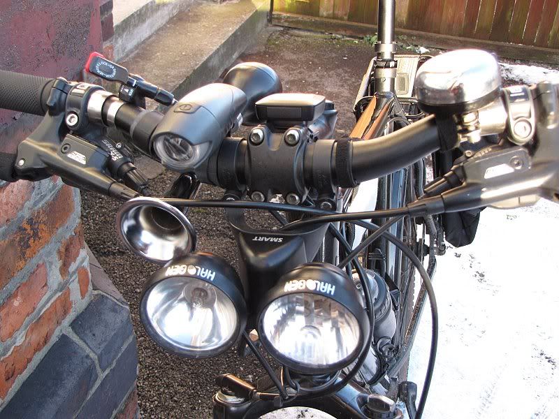

    I know this is the DIY lights forum, but there isn't a DIY Bells and Horns forum, and you mentioned the Bosch car horns, in the first post so I don't think this is thread highjacking: I want to know more about the horns.
    I looked in a car parts outlet and the current required for car horns seemed a bit taxing to use my light battery. I mean blast someone then run out of power for the lights doesn't work. Sounds like you are running a dedicated battery? Besides voltage, what capacity etc? Does the extra voltage alter the pitch of the horn? How about your ears as the rider? Is the sound directional enough away from you so your hearing isn't impaired?
    PRETENDURO
    7,815
    Quote Originally Posted by BrianMc
    I have used the cheap light meter and it seeems OK for comparison between lights but the actual readings may not be spot on actual output. A light or two of known output remedies that well enough for most of us. It is a help.
    My Surly 1x1 actually only runs one horn (made for a Japanese car, got it for $2 from American Science and Surplus), however, my Surly Big Dummy runs TWO horns. The horns came from a car I used to own (1987 Volvo 740 turbo wagon). All I did was wire them together in series, and pop a 6A rated momentary rocker switch in between. The power source is a 14.8V (actually 16.51V) 4400mAh Li-Ion pack from All-Battery.com. The battery pack has a circuit breaker in it in the case of too much current being demanded of it, but it hasn’t kicked in when using the horn. Of course, I don’t totally lay on the horn all the time, rather, a few short bursts is enough. The horns are actually overvolted (stock Volvo voltage regulation system governs the voltage to around 13V) so the 3.51V increase actually is overdriving the horns, the end result being they are slightly higher pitched, and SUBSTANTIALLY LOUDER than they are supposed to be.
    Oh yeah, and my ears for sure ring for a minute or so after using the horns on my Big Dummy!

    Have a just built and being tested 11.1 v 4.8 Ahr Li-ion pack (12.6 fresh off the charger) should be adequate, if not as loud as an overdrive. Cheap anyway. It is for the tailights and as a backup to the main battery. It would be rare for me to use the horn. There have been times, though. Once, maybe more if there are dogs. The pack has a 10A current limit in the PCB, so it sounds like I have a plan.

    Being seen and heard is a good idea. Could you guys post pics of your horn setups? Any thoughts by anyone on a compact super loud horn specifically made to mount on a bicycle?
    On my road bike in the middle of the day it would be great to have one for those drivers not paying attention
    We may need to make a new section, DIY Horns!
