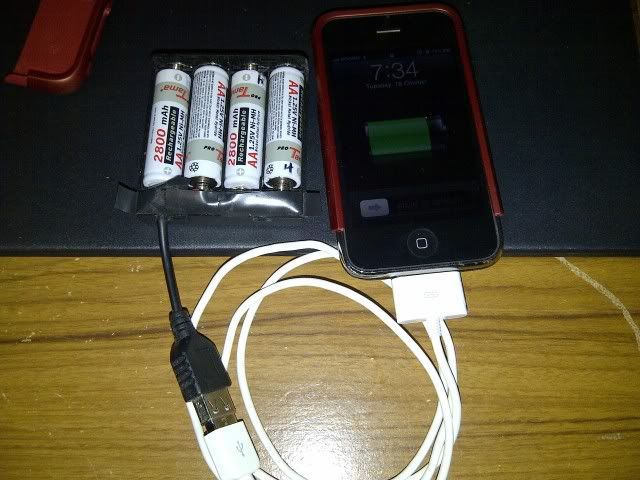

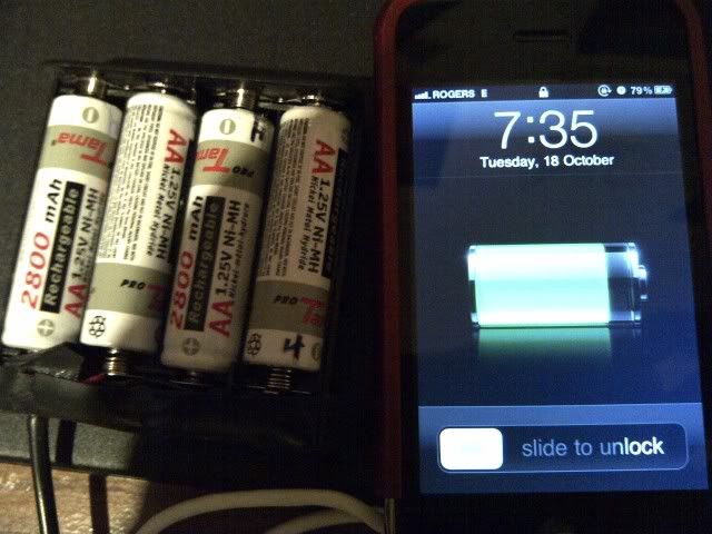

    I got from Radio Shack / The Source a four AA battery holder with switch and soldered a USB to it so I can recharge my ipod, blackberry and other small electronics.
    Here is a picture.
    It comes in handy when needed and if your re-chargeable run out of juice you can always use regular alkaline AA batteries in an emergency.
    The holder cost about $5. You can check it out here

    I think I'd rather spend a bit more and get something that supplies the correct voltage, given how much the things it's charging would cost to replace if they were damaged by excess charging voltage.
    Mar 2006
    515
    Most chargers, charge at 5v. With four batteries at 1.2V = 4.8V so there should be no worries of frying your device. I've used this for the last two yrs working out on the field / biking with no issues.
    But then again make and use at your own risk.
    2,342
    1.2V is the nominal voltage for NiCd/NiMh - fresh off the charger they're more like 1.4-1.5V. Same with alkalines - nominal 1.5V, fresh are ~1.6V. Not exactly the same, but I've seen people fry laptop motherboards using adapters that are only a volt or 2 higher than specified. Didn't happen immediately either, took a couple of months usually.
