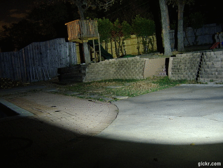

    MC-E N bin @ 3500mA Fraen Narrow reflector VS MC-E M bin @ 2400mA Fraen Narrow reflector
    The fins are probably needed for the N bin at 3500mA.
    Right of center shot is N bin. Much more intense center. Pic does not do justice to the difference between the two lights.
    Foreground tree in upper shot is about 44 foot from camera/light position.
    The double V shaped tree on the right of hot spot is at 110 foot.
    Trees in very back of shot are at 180 foot.
    Edit- Measure actual distance today and updated above.
    So the Fraen Narrow is giving me a sweet spot from about 80ft to 130 ft.

    1,311
    One complaint about the MS 900 was the spotiness of the reflector. The Fraen produces a similar beam. A somewhat bright ring and the beginning edge of the beam. The mid of the beam is a little dim and then a really hot spot.
    The Frean medium has a nice even fill throughout. Great light to compliment a spotty helmet beam.
    Some people do however like a spot on the bars and a flood on the helmet. Ride style and trail terrain does influence light set up.
    Make up your own mind.

    1,311
    Quote Originally Posted by jmitchell13
    Ummm??? But no one has ever lost a finger from mountain biking...
    Your welding glove story is enough to scare me away from the tablesaw technique.
    Not too sure about that.
    I have lost teeth and broken multiple bones biking.
    Notice the full face helmet.....

    1,311
    Quote Originally Posted by Vancbiker
    That's a bit harsh
    I have Fraen narrows in my current dual MC-E bar light. It has a beam that is very much to my liking. The previous MC-E lights I built with Ledil CMC-SS were OK but did not have the punch that I wanted. For me the Fraen narrow (in a dual set-up) has plenty of spill for slower twisty stuff. Then when you hit the open bits or fireroad back to the truck the range you have is great.
    No Worries.
    A dual would greatly increase near and mid flood. For a single though, it isn't for me.
    There's that pesky ride style and terrain issue. We all have preferences.
    Narrow on the bars just makes me angry.
