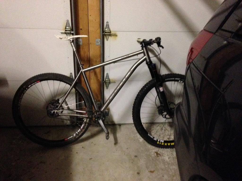

    Pics or it didn't happen...j/k
    That's a 140mm Pike reduced to 120mm. I'm waiting for the Process 111 frames to become available, so thought I'd go ahead and drop the Pike in preparation for that frame and use it on this one in the meantime.
    Hope to get out on it this weekend. Sucks only the "garage" pic, but finished it last night and no time to get it outside for proper documentation.

    Nice shot SCRX.
    Is that a 2.2 Ikon on the rear? I tried a 2.35 with the sliders all the way forward and it just brushed the chainstay bridge, so no go. My 2.2 fits fine though...
    402
    Yeah, 2.2 Ikon. Works well for this bike and the rides I like to do on it. What are you running in front?
    fnInt(1/x^2,x,0,1)
    Reputation: fleanutz's Avatar
    441
    That front wheel has a Maxxis Minion DHF 29x2.5 tire on it. Super heavy but great traction. Good for winter riding.
