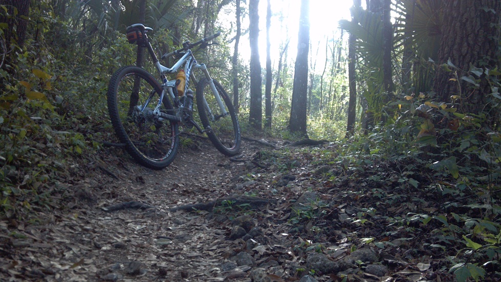

    After over 150 miles and about 14 hours of riding, all single track trails, the 2012 Kona Hei Hei gets a thumbs up! LOVING this bike. It’s fast, comfortable and handles great. A beautiful bike, white with blue and black trim. This is my second Kona, I think they are a cool brand, and I like that they aren’t so common that every other rider is on one. Other bikes I was considering were the Giant Anthem and Salsa Spearfish, but the Kona Hei Hei has something that stirs me to want to go ride it.
    Longest ride so far has been 40 miles, all single track. Not a single issue or problem with the bike. It is GREAT on fast, curvy, flowing single track and I’m getting around on the super tight trail sections at least as quickly as the 26 inch wheeled GT it replaces. I do plan to take both bikes out one day and ride the same trails, same day on both and see what Strava tells me about them!
    I started with a 19 inch framed 2012 Kona Hei Hei 29r at closeout pricing, then made a few upgrades shown below…

    Weight – 25.1 lbs. ready to ride, including pedals, bar ends, water bottle cage

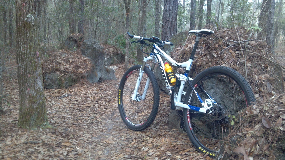

    FRAME/BIKE:
    I originally was leaning toward an 18 inch frame, just because I normally have to decide between Medium or Large, or 18 / 20 inch size, and I’ve found I do better on the smaller size rather than larger. But Kona offers 18, 19 and 20 inch frame sizes (and others), so the 19 really sits right between the Medium and Large that I would usually have to decide between, AND since my only option at the closeout price I was paying was a 19 inch, that’s what I got. Any worries that it would be too big were completely unfounded. I have never given it a thought while riding, all of those miles single track and some rather technical terrain. Size is perfect and I’m glad I couldn’t get the 18.
    Only one set of water bottle bosses, on the downtube, which seems to be almost a standard for many MTB bikes now. I hate that, I prefer two water bottles at least, SOMEWHERE. I hate using a Camelbak unless I just have to, and even then, I like being able to have additional fluids or calories available in bottles. Florida is HOT in summer.
    I have already done a temporary 2nd mount UNDER the downtube, and carried two 28oz bottles on my last ride of 40 miles and 3:30 hours, much of that rocky/rooty single track. Worked great and I’ll probably keep that 2nd mount there, really wish it was on proper water bottle bosses though.
    After getting the tires sorted out, the 29 inch wheels are awesome and the bike just eats up flowing single track trails. I’m getting more comfortable and faster on each ride.
    I moved the carbon handlebars from my old bike, 23 inch flat bars, with short barends. Can’t see any reason to change them, they are MUCH narrower than the current trend to wide, riser bars like the Hei Hei came with, but I like them, maybe from a lifetime of road riding that width just feels right.
    When setting up the levers/ grips/barends on the bars, before cutting the rubber grips or making any permanent modifications , I decided to wrap the grip section with some leftover padded tape from my road bike, just until I was sure how I wanted everything to be laid out. I’ve not given it a thought while riding, and I’ll likely keep this setup for now. It weights nothing, is easy to replace and I’ve been comfortable on it.
