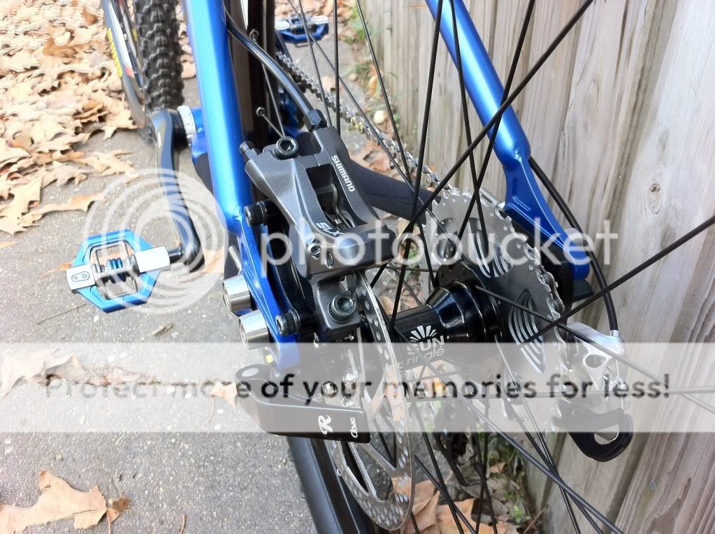

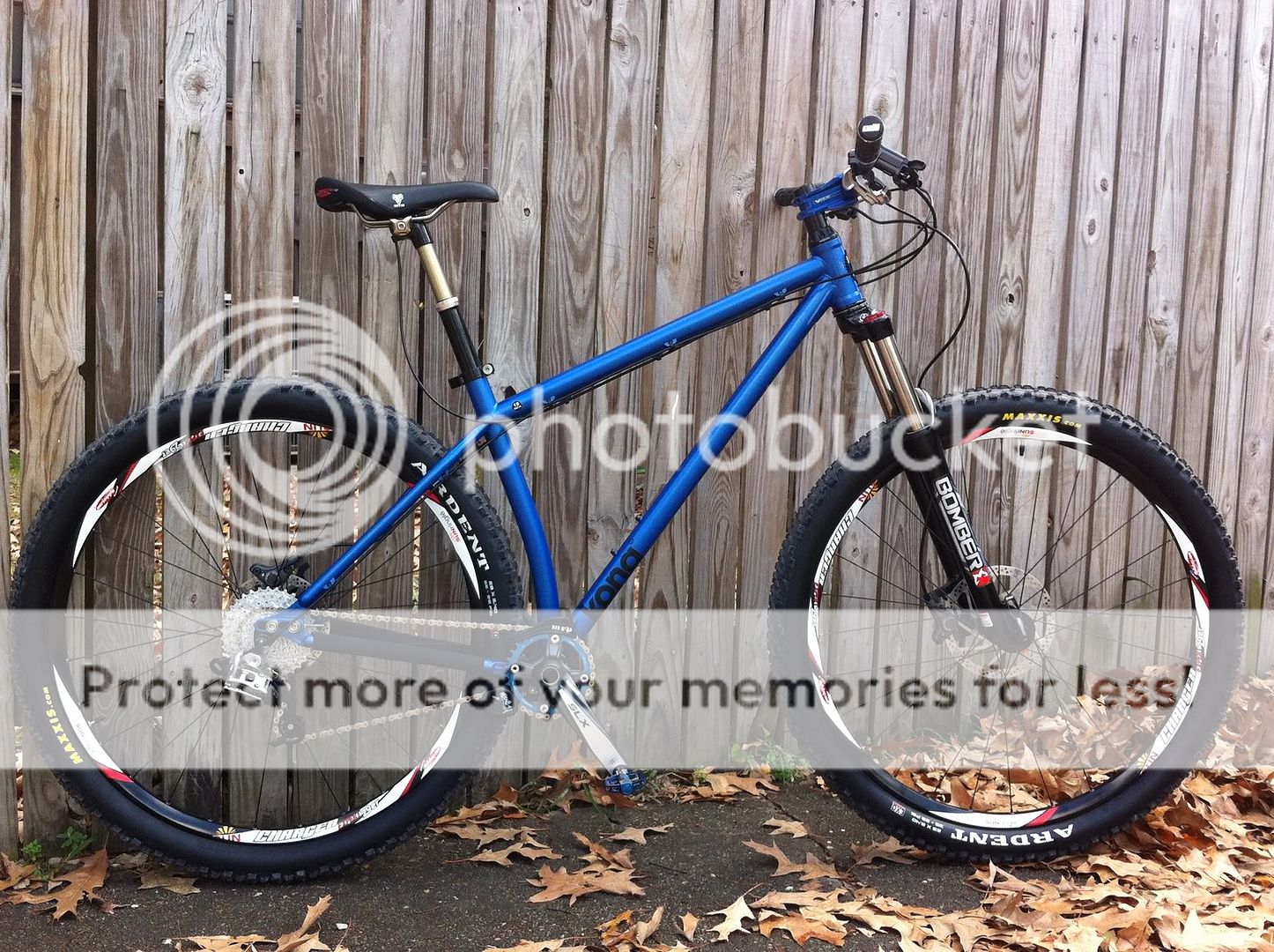

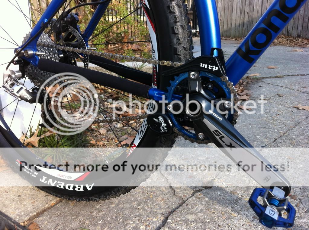

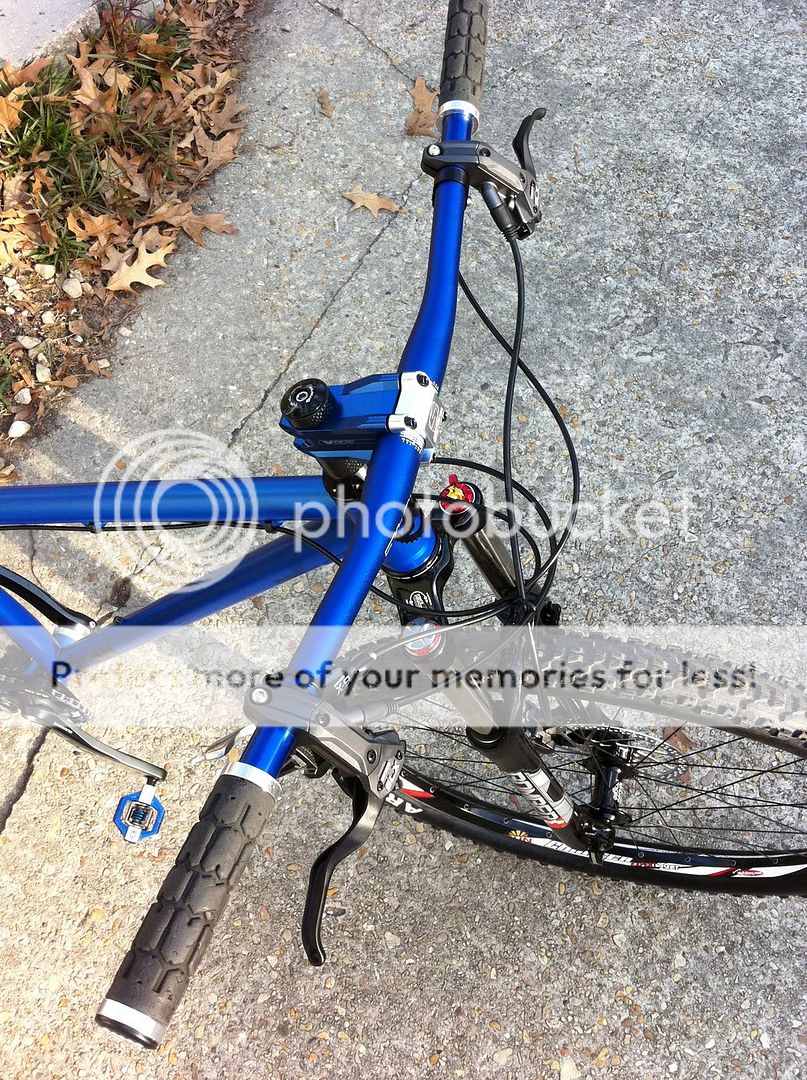

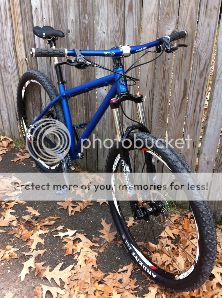

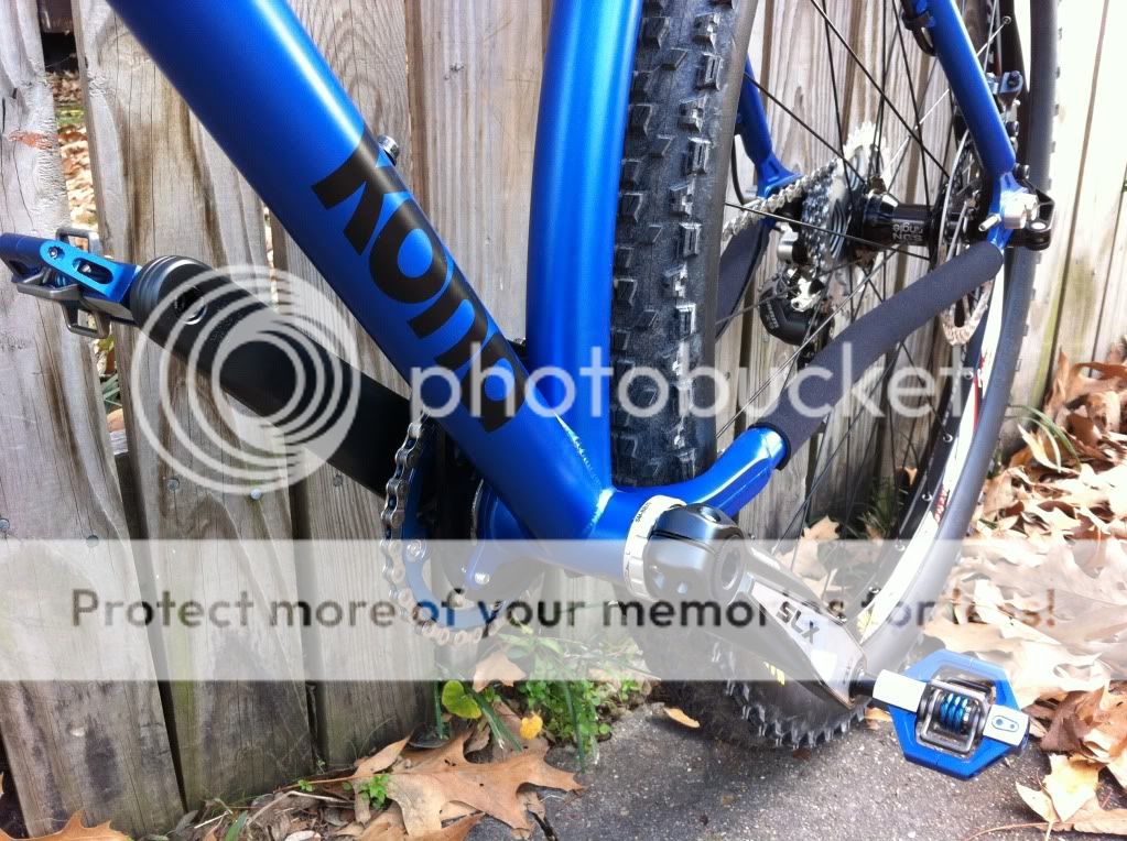

    I received my frame (which included a seat collar and cable clips) last week and so far I have scraped together for the build this stuff:
    SunRingle Charger Experts (black)
    Marz 44 Micro Ti 140 Taper (black)
    SLX crankset (rings removed)
    e*13 32t (blue)
    SLX brakes w/ 180/160 XT rotors
    Crank Brothers Joplin
    WTB Rocket Team
    Sunline V1 65/0 stem (blue)
    Sunline V1 762mm flat bars (blue)
    Syncros Hardcore ZS44 Tall Upper
    Can Creek EC44 lower
    ODI Rogues
    X.9 short cage
    x.9 rear trigger
    Sram 971 11-34 cassette
    1 can of frame saver
    Sram 971 chain
    CB Candy SL (blue)
    Over the next few weeks these will follow:
    MRP Lopes SL chain guide ISCG05
    undecided tires

    These Syncros headsets are on par with Kings and 110s, IMO, plus I need the height of the RWC Externalizer to keep my geometry in spec.
    Nice build btw...

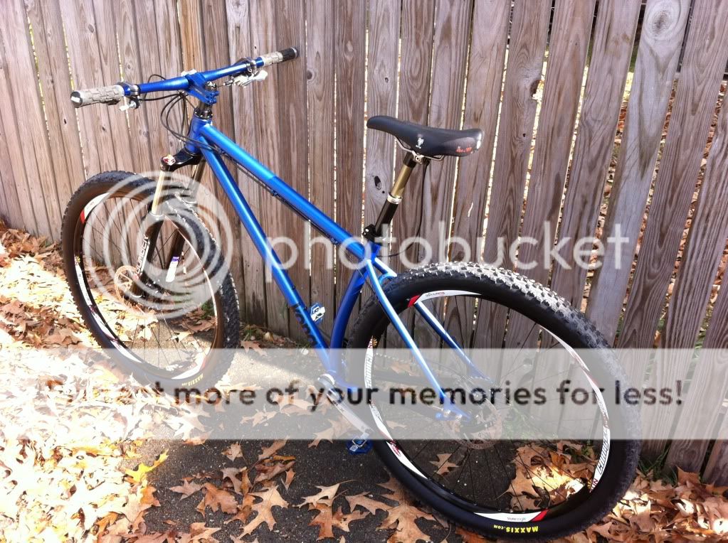

    Here's my build
    20" Honzo frame. Bike had all the standard build kit when I got it. No bare frames avail in 20".
    From the stock build I've kept the 120mm revelation fork, chain guide, cranks, bb, cassette, seat post collar, and headset.
    Build:
    RockShox Revelation RL Dual Air 120mm/20mm DO
    FSA Step-Up cranks
    FSA The Pig headset (I have a King headset on back order)
    e13 ls1 chain guide
    Niner carbon flat top bar
    FSA SLK carbon seat post
    WTB Rocket V saddle
    X9 shifter
    X9 rear derailleur
    Shimano HG61 12-36 9 spd
    Elixir 9 brakes with 180mm rotors
    Thomson 80mm 0 degree stem
    Arch rims laced to DT Swiss 240s hubs with blue nipples
    2.2 kenda slant six up front
    2.1 kenda small block 8 in the rear
    (36 teeth upgrade for rear hub on my workbench just waiting to be installed)
    Currently have oury grips but I have odi rogues sitting here. Just waiting for my blue clamps.
    I'll convert to single speed when I have the legs built up. Coming from a 3x10 this 1x9 is a pretty good work out. Loving the bike.

  • 12-24-2011
    carabao
    Updated pic of my Honzo, wider bar (Raceface SIXC 725mm 9/4 sweep) and shorter stem (Thomson 50mm).
    <a href="http://www.flickr.com/photos/carabaoray/6625861393/" title="IMG_0810 by carabaoray, on Flickr"><img src="http://farm8.staticflickr.com/7028/6625861393_03f6304cbc_b.jpg" width="1024" height="640" alt="IMG_0810"></a>

  • 01-07-2012
    eauxgod
    Plenty of room here too with Ardent 2.4s mounted to Charger Experts @ 40psi tubless for the initial set up...
  • 01-08-2012
    eauxgod
    Sun Ringle Charger Experts (stickers to be removed)
    Ardent 2.4s, tubeless
    SLX cranks
    e*13 32t
    Crank Brothers Joplin (temporary...)
    WTB Rocket Team
    Cane Creek EC44 lower
    ODI Rogues
    X.9 short cage
    X.9 rear trigger
    Crank Brother Candy 3 Cands
    Right at 30 lbs...
  • 01-08-2012
