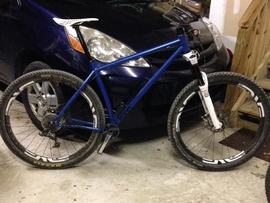

    Honzo SS Rigid Semi Fat
    Clydesdale CrossCountry version here~(Honzos can climb too!)
    Been rockin the Honz as SS and Salsa Cromoto 15maxle Rigid with 29x3.0 front for 6mos. Settting new PR's all the time - loving it.
    *QUESTION IS...anyone on the '15/16 think there's room in the back for the 29+ tire? I know B+ is should be ok on them...but I'm lookin to jam a 9+.. Would make a great Ros9+ or Trek Stache killer!
    Love the Honzo. Ride on!
    Attached Thumbnails Attached Thumbnails Honzo Build Thread - post your builds here-hssrfatty.jpg
  44. #2644

    Custom Honzo Build
    Large Honzo. Only two rides but digging the nimbleness in the twisties. Way quicker than my long Spearfish.
    Attached Thumbnails Attached Thumbnails Honzo Build Thread - post your builds here-image.jpg
  99. #2699
    Nov 2015
    15
    Hi all. My first post on this forum. Only fitting it should be in the thread that is largely responsible for me owning this lovely 2012 Honzo 20L. Zee discs, XT breaks, 40mm stem and 785mm bars. Powder coated chrome and set up with 142x12 dropouts and a Koozer hub. Thanks for all the inspiration Honzo Build Thread - post your builds here-honzo.jpg
  100. #2700
    962
    ^^ This one looks awesome. I like the skinwalls!
