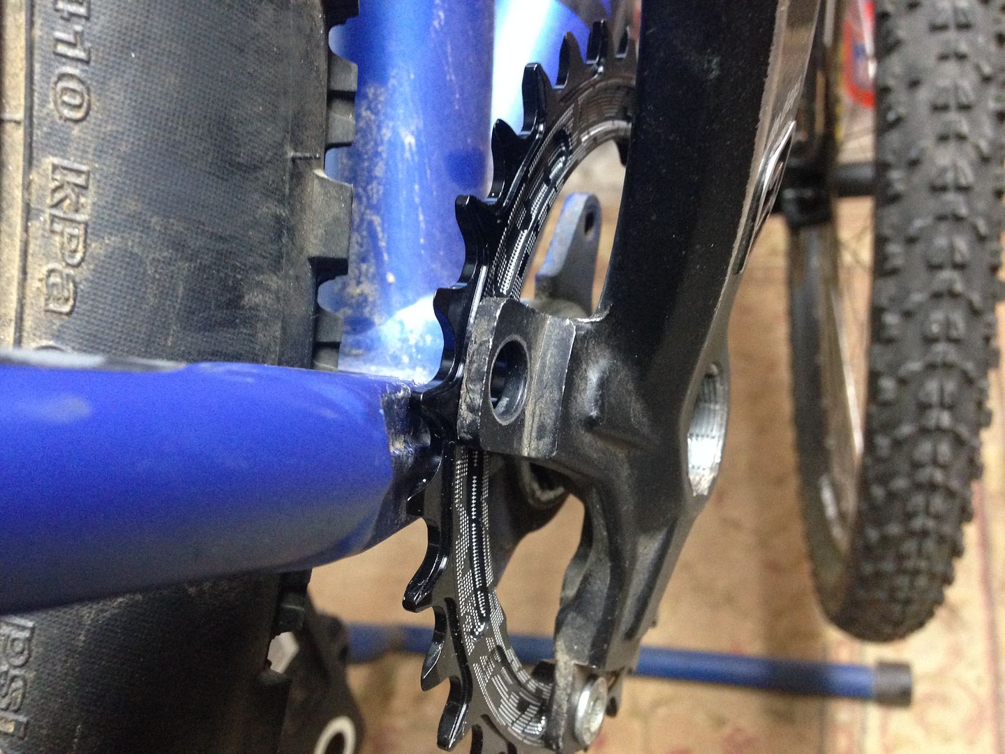

    Birchwood
    Hey fellas, Im wondering if you could lend me some advice. I have a 2012 Honzo and recently purchased everything to convert it to a 10-speed (Zee short cage, SLX cassette, Zee shifter, SLX chain and RF narrow wide). Now, when I bolt the chainring up (to the stock Kona crankset), there is ZERO clearance between the ring and the chainstay. Anybody have any suggestions? Is it possible the crank arm is too close? Is it acceptable to run the sprocket on the front side of the spider? Any help would be greatly appreciated- I would really love to ride the new setup as soon as possible.

    Birchwood
    No picture at the moment. The NW is a 32 tooth (same as the stock ring). when i bolt it to the crank, it rubs the seatstay. im thinking i may have torqued the crank arm down to much? If this isnt the case, would you think its ok to run the ring on the outside of the crank? I dont see why not, the spider looks asif ts designed to run a ring on either side.
  • 05-28-2015

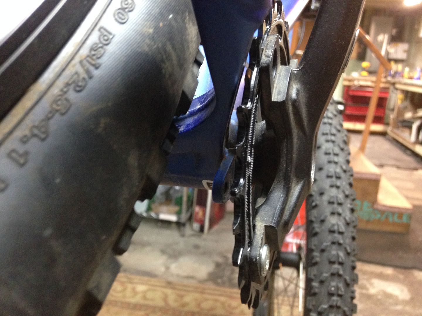

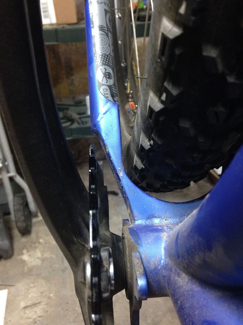

    Birchwood
    OK, so heres some pics. you can see that the chainring is pressed right against the chainstay
    However, if i mount it to the outside of the spider, there is plenty of clearance. Anybody think this would pose an issue?

    TheOrca
    It is supposed to go on the outside of that spider. The chainring should fit perfectly on that ledge that drops down to the bolt hole from the crank spindle.

    bog
    Something seems wrong there. It should normally fit on the inside of the spider where a middle ring would normally be. Looks like the stock setup is mounted on the inside and works ok. What was on there previously? Is the RF ring thicker?

    natedoggie89
    It's because you are using a square taper, isis or octalink bottom bracket that doesn't have a long enough spindle length to run the chainring on the inside. Just run it on the outside or get another bottom bracket with a longer spindle.

    Collins
    ^That's the ticket. If you're looking to upgrade a bit more, get an external bottom bracket and a hollow spindle crank (Shimano SLX is a steal). Easy to maintain, and it'll lighten your setup as well.
    Otherwise, sure, just run it on the outside; no problem there.

    bog
    Chainline will likely suck.
  • 05-29-2015
    natedoggie89
    No doubt, your drivetrain will wear faster but you shouldn't have any problems with it shifting if you do run it as is. ISIS bottom brackets are cheap, as a wrench I would recommend getting the correct one for proper chainline but if you can't swing it, it will be fine. They have the small bearings and wear out relatively quickly though so add me onto the list of upgrading to something with external bearings and cranks with a larger diameter spindle as well!
