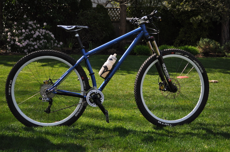

    Out here in the high desert, a steel frame would probably last 40+ years without any real attention, although I always wipe mine down after her bath!
    I've seen steel water tanks go over 30 years between re-coats.

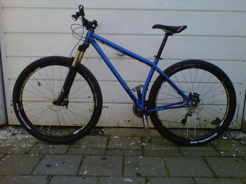

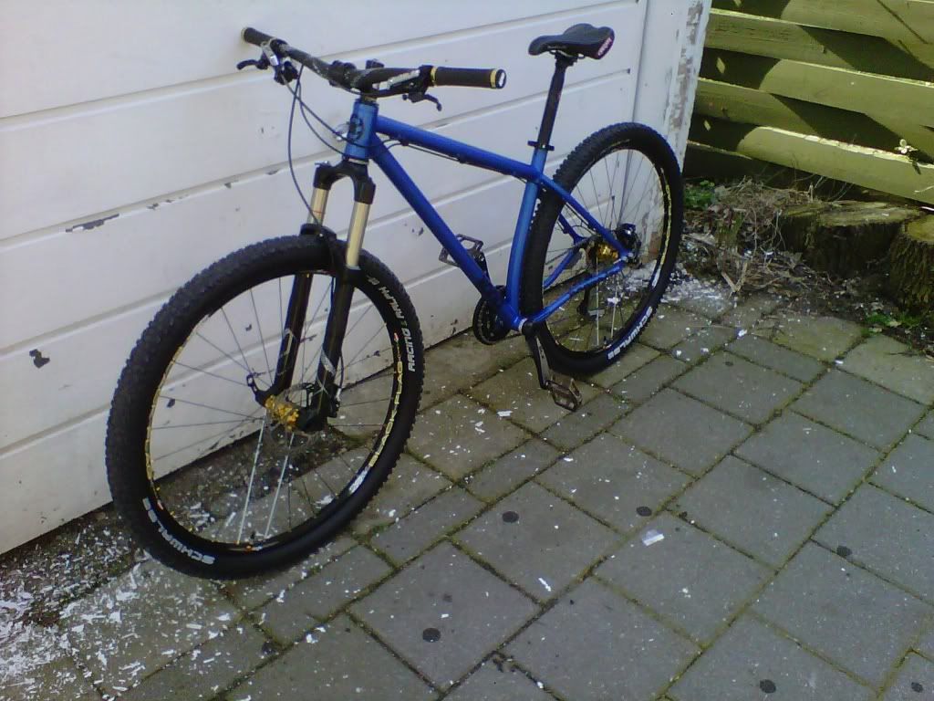

    Dinglespeed...
    Just one of those bikes you love to play around with. Off with the drivetrain and on with a Hammerschmidt!
    22/36 with a 22t in the back so far.
    -D

    Just built up the Honzo on Friday and had two great rides over the weekend.
    Build:
    18" Honzo
    Marzocchi 44 micro ti
    Sun Ringle Chargers
    WTB Bronson tires
    Sunline bar and stem
    Formula the One brakes
    x7 shifters and cranks
    x9 rear der.
    Blackspire stinger e-type chainguide with XT front der.
    XT cassette
    Chromag moon saddle
    Straitline pedals
  76. #176
    Bnerd
    Reputation: RideEverything's Avatar
    770
    Quote Originally Posted by Mad-Duck View Post
    So, it can be done!
    I was thinking of setting an FD up exactly like this!
    Could you post some close-up pics of the Stinger-E where the FD is bolted on?
    Does the FD come into contact with the rear tire at all?
    What are you using as a cable stop on the seat tube for the FD? (I can't tell from the picture)
    What BB do you have and what spacers, if any, are you using to sort out the chain line?
    I was told by the Kona Tech support on the Konaworld site that it was impossible to run an FD how you have it set up!

    Quote Originally Posted by RideEverything View Post
    So, it can be done!
    I'll try to remember to get some closer pics later.
    I can't slam the wheel with this setup, but I can get it to about 16.5" while still leaving about a 1/4" of clearance from the body of the FD. The side lugs are fairly close to the cage of the FD with about 1/8" gap.
    I'm using an axiom cable stop, but problem solvers should have some that would work too.
    The bb is the one that came with the X7 cranks. I can only use the one spacer on the drive side with these cranks. Any more spacers and I can't get the cranks on tight without seizing them up. Because of that I had to take a belt sander to the chainguide plate and file down the granny gear bolts to have enough space between the chainguide and cranks. With Shimano cranks you could probably avoid all that.
    Also, the stinger guide is meant for up to a 40t chain ring, but the honzo won't allow a ring that big. With my chain line a 38t wouldn't fit either. With a 33t ring and a 36t bash guard, the derailleur was too high up and caused some chain rubbing on the front derailleur, so I drilled new holes and cut off the extra part of the guide.
    Everything works quiet well now and it makes the Honzo a much more capable trail bike for long rides.
    Build:
    18" Honzo
    Sun Ringle Chargers
    WTB Bronson tires
    Formula the One breaks
    x9 rear der.
    XT cassette
    Chromag moon saddle
    Straitline pedals
    Nice build!...impressive work with that front der.... I like the white rims and the white bashguard - cool and original...
    Are you running 140mm on that Marzocchi?
  79. #179
    Mar 2011
    37
    Quote Originally Posted by CBizzie View Post
    Thanks! Yup, they're at 140mm.
